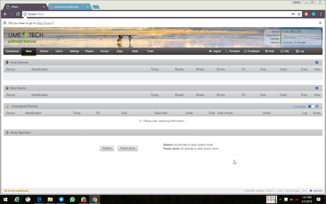

I have this weird problem where it says that Array undefined at the bottom of tower/ home page (see screenshot). This is the second time it happen. The first time I reset my unraid box and after reset, it works fine. All drives are green. Then it happen again.
When it happen, I can still access my shares. Ssh also works. But my internet is downed. Lan pinging results in lots of no response.
Anyway, whats the problem and what should I do? Have anyone experience this before?
