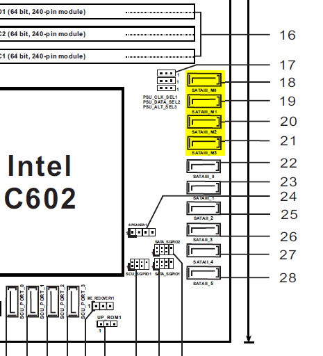

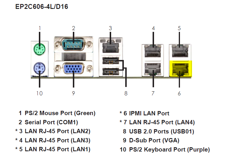

That port 1 is probably the IPMI network port.  On the ASRock - EP2C602-4L/D16 the IPMI nic port is definitely not intuitive where it is placed.  Highlighted port is the IPMI port on the IO backplane.  Also with unRAID 6.x I was never able to get the onboard marvel 9230 controller to work acceptably and disabled it and removed all drives connected to it.  That is the other graphic with the marvel ports highlighted.  Note the EP2C606-4L/D16 which is in my graphic is the same layout as the EP2C602-4L/D16 - opps!

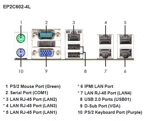

I have the EP2C602-4L/D16 and just assumed (incorrectly) that the correct port would be port 5 (LAN 1).
