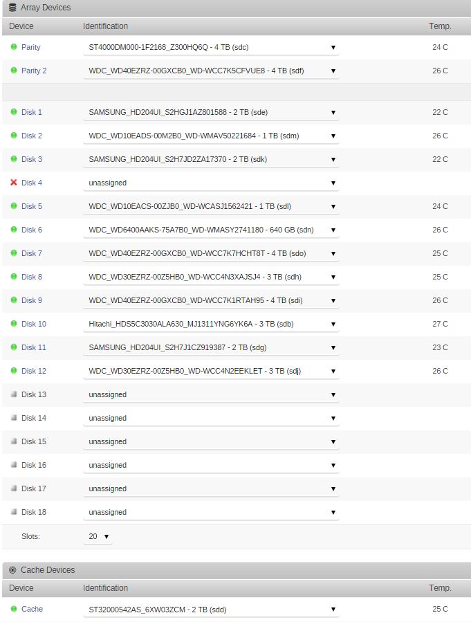

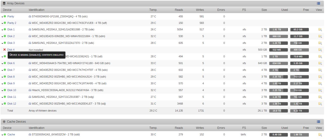

1.  The red X next to Disk 4 under Array Devices notes 'Device is missing (disabled), contents emulated'.  Do I stop the array, unassign Disk 12 for example, and then assign that 3tb WD to be Disk 4?  Is it going to bark at me?  Will this invoke an array rebuild?

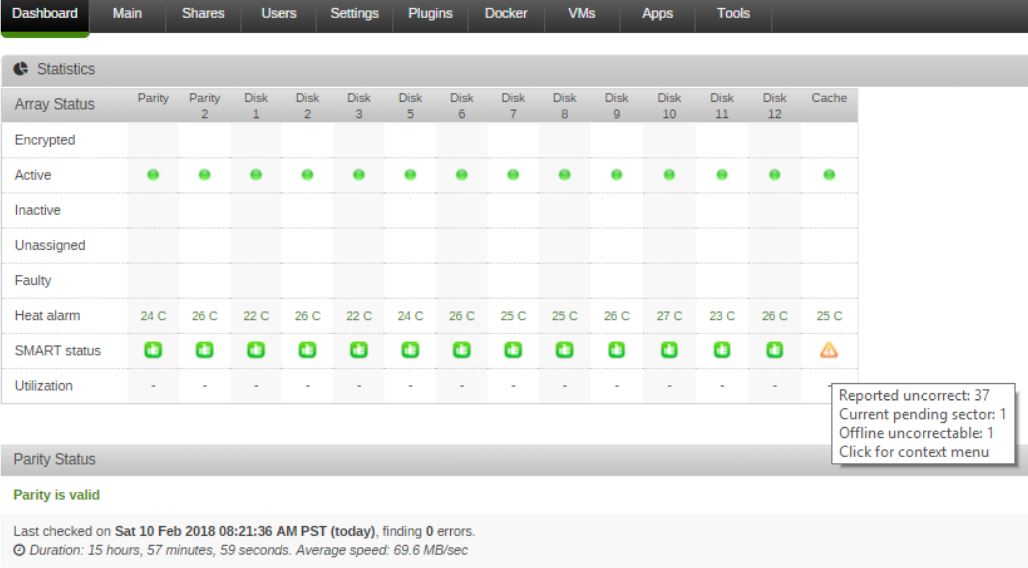

2.  The Cache drive under Cache Devices, I've lost confidence in it as it seems it is on it's way to failing.  Is  this true?
I've attached it's SMART info, but running the extended self-test showed 10% progress and then 'Errors occurred - Check SMART report', but I'm not really sure what I'm looking for.  The FAQ talks about replacing a Cache drive, but not removing it as far as I can tell.  Can I remove the Cache?  Or would it be best to remove one of my 2tb drives (i.e. Disk 11) from the Array and reassign it as Cache?

Edit:  I had to shut down the server since I was working on my house between this morning between the latest array rebuild and posting this, in case seeing 'finding o errors' is significant in this first pic attached.
You can't assign an existing array disk to rebuild disk4, you need a new disk.
Yes
Basically your only options with regard to disk4 is to rebuild it to a disk not already in the array, or set a New Config without it and resync (rebuild) parity instead.
