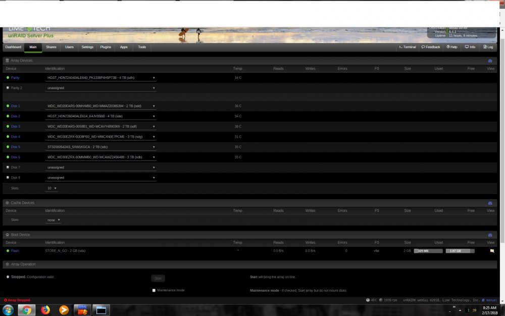

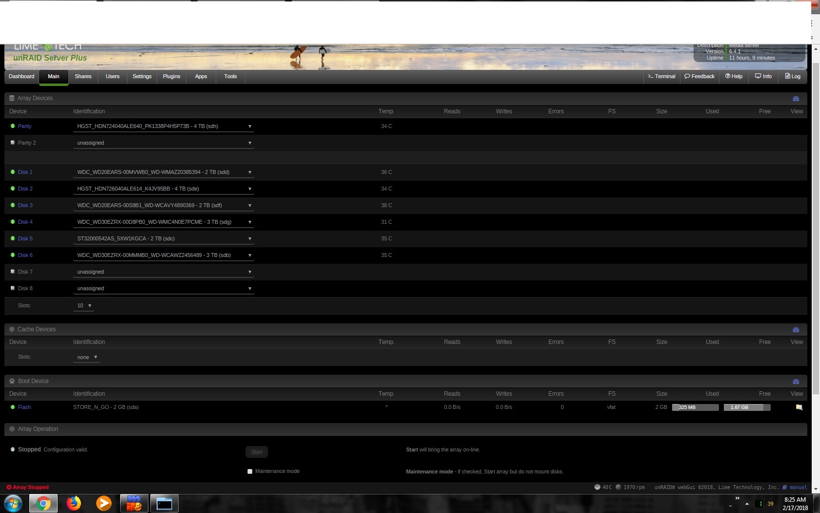

Please post your diagnostics: Tools -> Diagnostics and current main page screenshot.

now with screenshot
