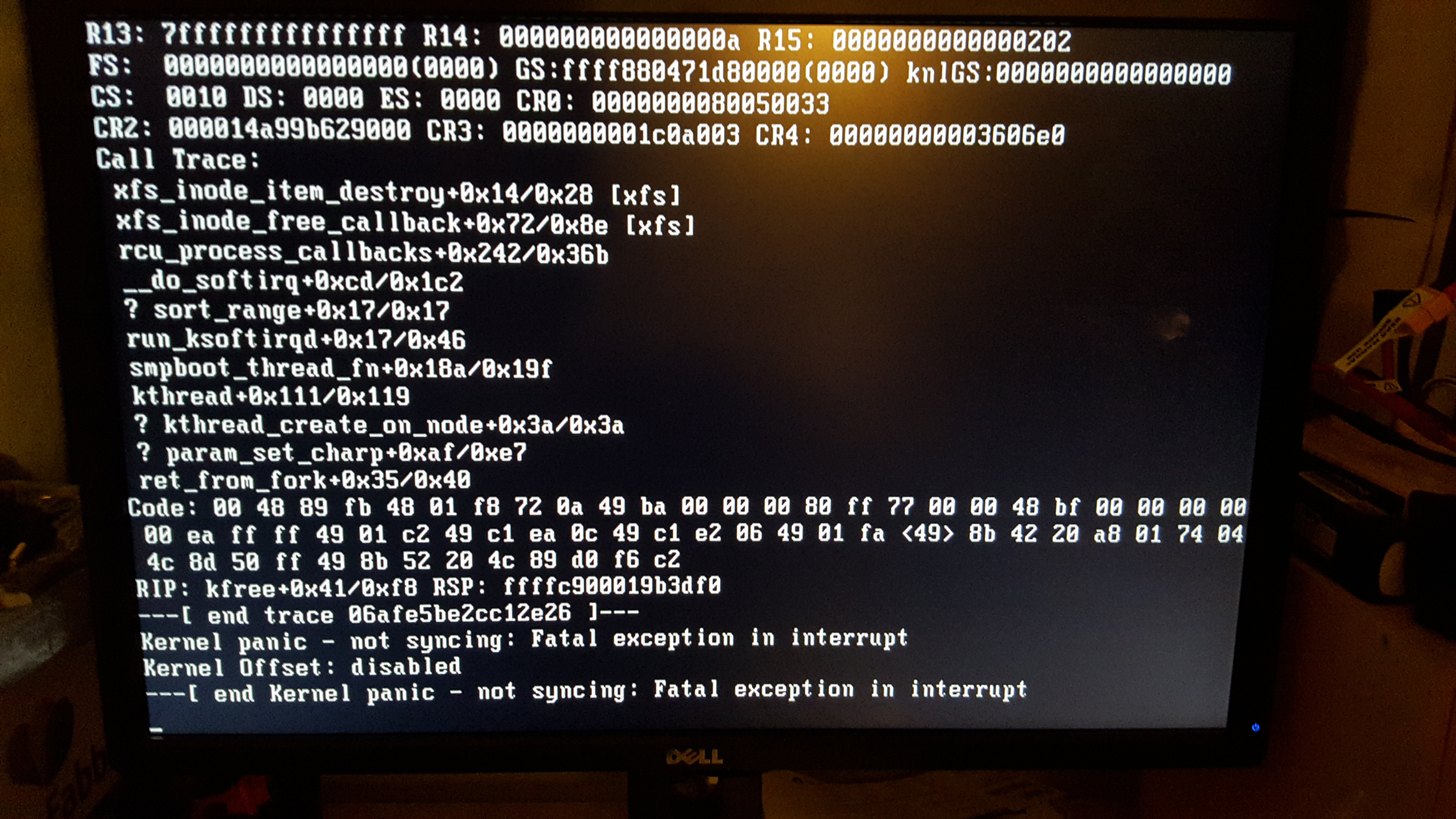

I'm using unRAID 6.4.1 and every few weeks I discover that my server has crashed with a kernel panic.  I've not managed to go about getting hold of a syslog or any proper diagnosis.  I've attached a photo of the screen once the panic has occurred.

As the backtrack shows the crash is occurring in the XFS driver, the 1st thing I would do is run a file system check on your disks .... you might have some file system corruption which is causing the driver to crash when that part of the file system is accessed.
