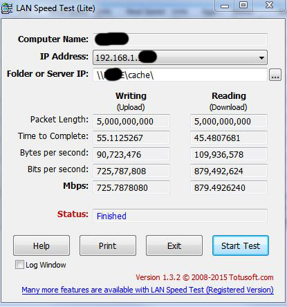

HEre is an suggestion.  I have used a program named LAN_Speed test.  you can find it here:
     https://totusoft.com/lanspeed
I used version 1.3 Lite (in the Download section on the right side of the screen).  The version does not even require installation.  Thje download is actually an .exe file and you can run it from anyplace.  (Warning---  You should check any file that you download from the Internet and verify that it is safe to use.)  However, I have been using it off and on since I downloaded it in 2016 BUT this was almost two years ago...
Here is the output that I got from 5GB file that I choose to use as a test size:
As you can see, I had an upload speed of 90MBs to a small 'Spinner' cache drive.  If you decide to use this program, try both to your cache drive and to a Share where you are not using the cache drive.  (i.e., writing directly to the array.  You might want  to create a test share to do this but it should be easy to get rid of the share later as LANSpeed deletes the file as part of it test procedure.)

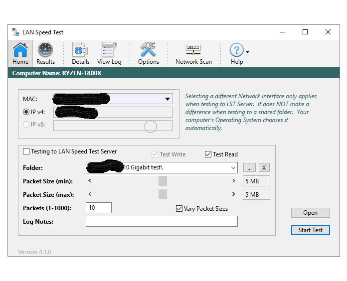

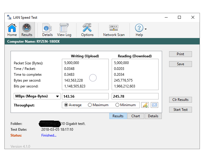

Hum so I bought it $10 no problem thanks for the link with the crappy luck I have I will need this often but now the strange part sure looks right to me remember this is a 2 ssd cache pool in raid 0
test1.png.673775fe15b4e49d9230b889738e1165.pngtest2.png.dfe8217c902f988836a392a44892128d.png
I spent a fair period of time puzzling over your results until I suddenly realized your have a 10Gb LAN setup.  I am not prepared to very discuss what your write (and read) speed should be to your sdd's.  Someone with some experience with them will have to address that.  Remember, most folks are still using 1Gbs LAN.  And the write speeds that this test reported would support that support those data rates.

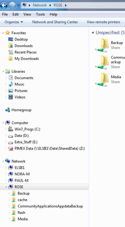

I notice that you were doing your transfer tests  using mapped drives  (Z:).  Let's try something different.
Since I don't use Win10, I am at a bit of loss to describe how to do what I am purposing.  If you have a Network icon on the desktop, open that up and pick your server out of the choice and open that up and navigate to the point where you want to make your copy test to.   Now open up your file manager, and drop-and-drag your test file from one widow to the other.
If there isn't a Network icon, Open the file manager and start looking for your Network.  It looks like this in Win7:
Do the same thing as above.
