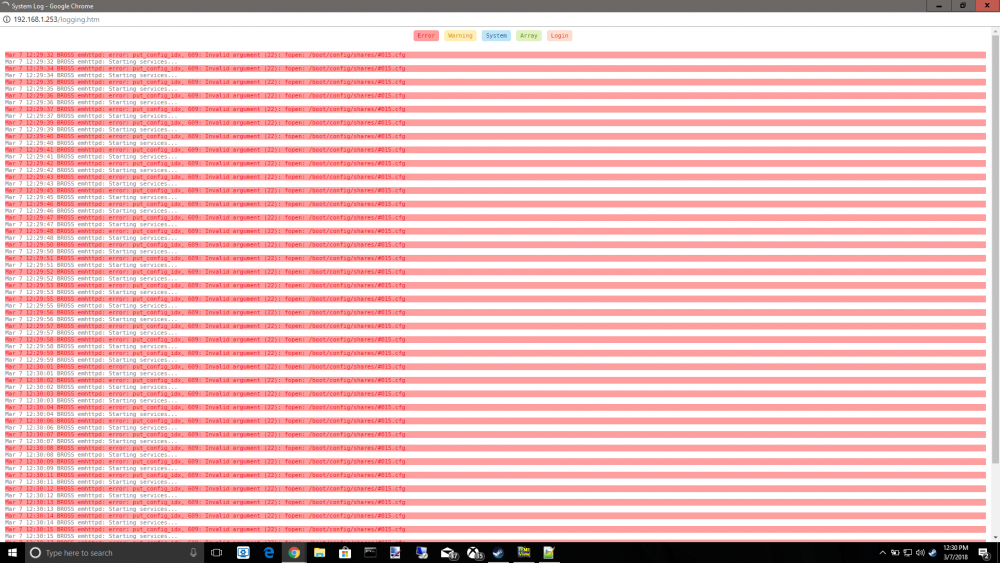

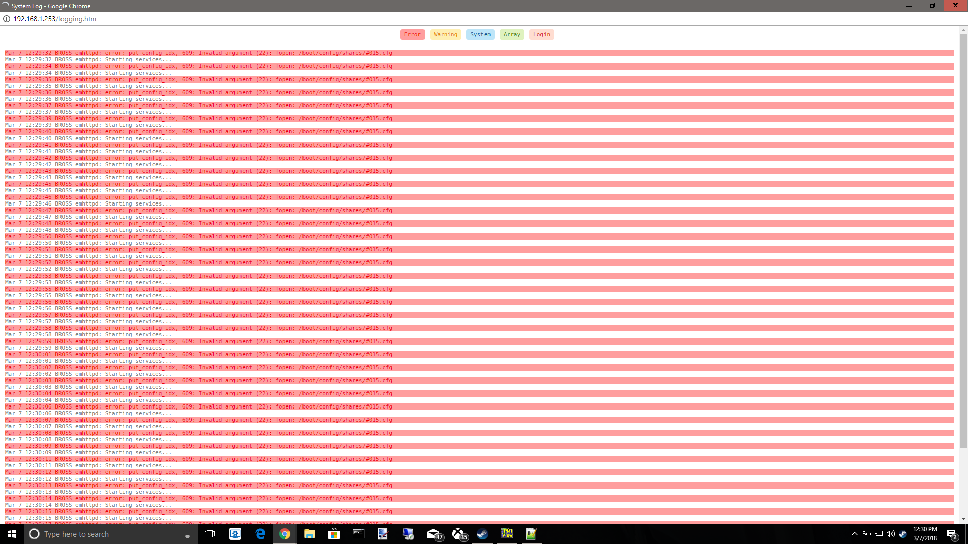

Hello, all. After finally upgrading to 6.4.1 I have a continuous error popping up every second in my log. I'll attach a screenshot and add the error as code. I'm also seeing a continuous "Starting Services" on the bottom of my webgui.
Mar 7 12:29:40 BROSS emhttpd: error: put_config_idx, 609: Invalid argument (22): fopen: /boot/config/shares/#015.cfg
Mar 7 12:29:40 BROSS emhttpd: Starting services...
Has anyone else experienced this or have insight on how to fix this?
Thanks in advance
- naturalcarr

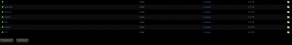

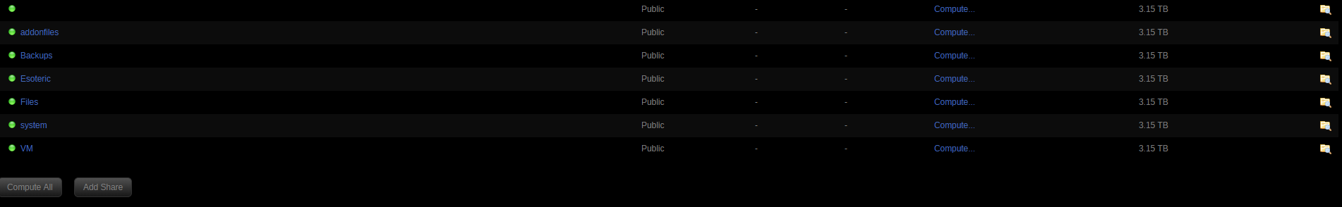

I don't. My shares are:
  • addonfikes
  • Backups
  • esoteric
  • Files
  • system
  • VM
Edited by naturalcarr
