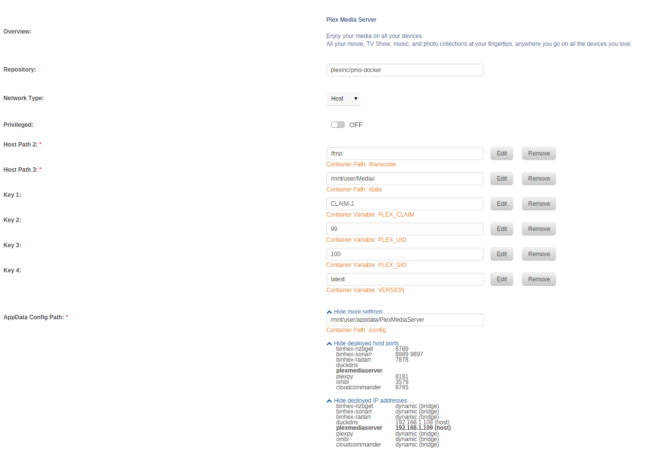

Just incase there is something that stands out I posed my docker settings.

22 hours ago, crspangenberg said:
10/4, I posted on the Plex forums so I'm hoping for a response there, but It seems like I had this issue with Binhex-plexpass and that is why i switched over to plexinc, I only seem to be having issues with Plex though.
I am using same version as you (Plex inc) without any difficulties.
Only setting I have that is different is the mapping to the appdata folder, I am using /mnt/cache/appdata/Plex/ where you have /mnt/user/appdata/PlexMediaServer/
I don't believe that it makes any difference but you could try changing from /user/ to /cache (from user share to disk share, assuming you are using a cashe disk).
I has been mentioned for other containers that this could make a difference.
So far it seems like this worked Leifgg, Plex updated on Sunday and is still working so that is a plus. I will let you know if it maintains.
