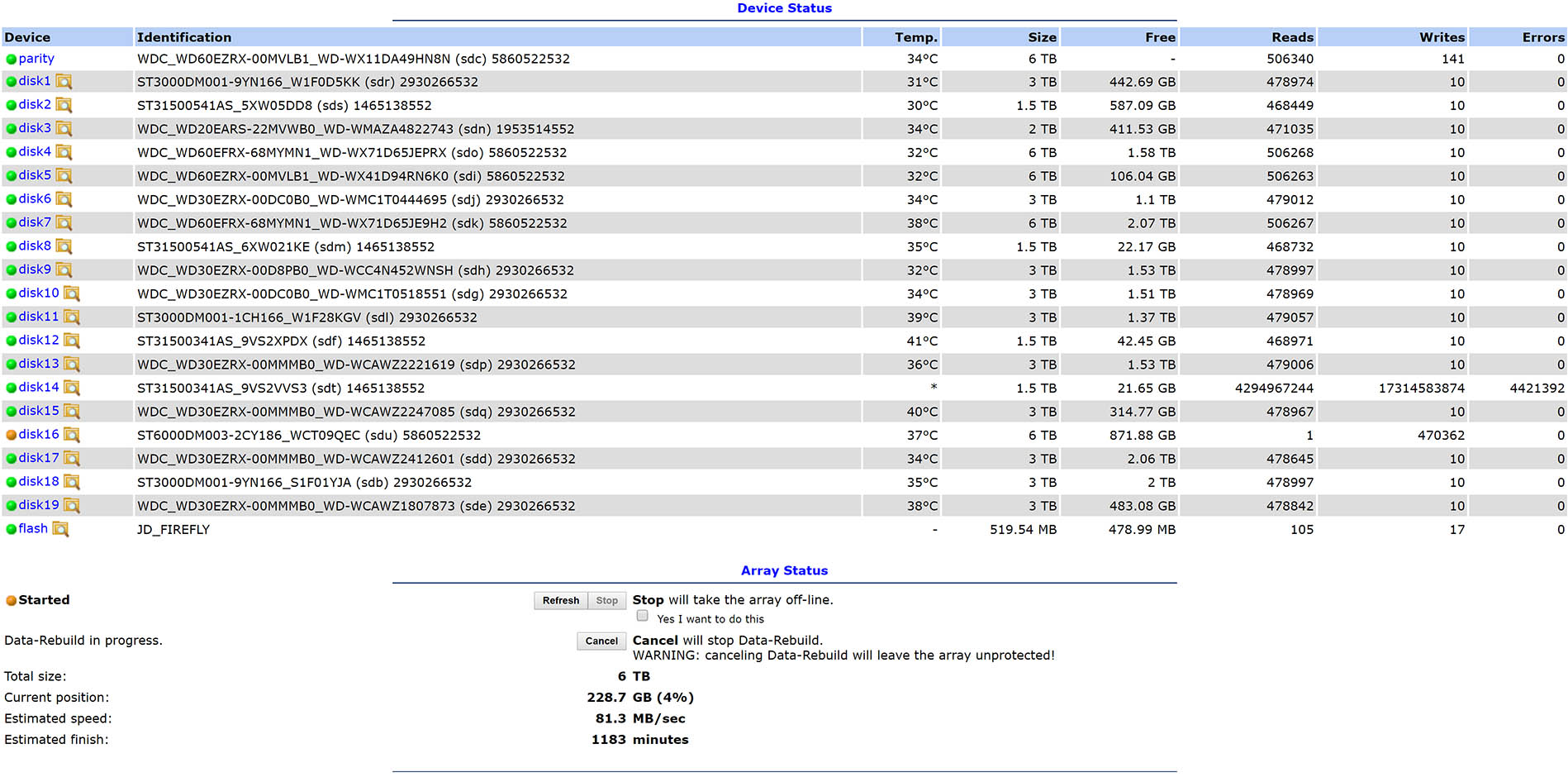

My rebuild from that point went great, tooling around at 100 MB/s. However, at approximately the 3% mark, another one of my disks started reporting a ton of errors, disk14, a 1.5TB drive (also the temperature of this drive was replaced with an asterisk). The rebuild progress still seemingly continued, but the new drive (the one that replaced the redballed drive) was no longer accumulating "writes" and the "errors" drive was accumulating errors. I hope this makes sense.
I stopped and tried again. Same thing. Right around the 3% mark, the redballed drive stopped accumulating writes and the other drive's temp was replaced with an asterisk and it was reporting errors. When I refresh the GUI, the errors keep mounting, and the redballed drive is no longer being written to.
At this point I realized that a lot of my drives were running really hot. So I looked at my fan situation and tried to improve them (I had moved recently and some of the fans in my case had become unattached to their anchors). I tried my rebuild again, and overall temps were reduced by about 8 degrees per disk. That was an improvement, but unfortunately, the same thing happened again.
I have attached a screenshot of my GUI and also my syslog. I am going to stop the current rebuild. It is currently at 405GB (7%), but the red-balled drive isn't being written to and the only thing that seems to be happening is the errors for the green-but-troubled drive are ticking upwards.

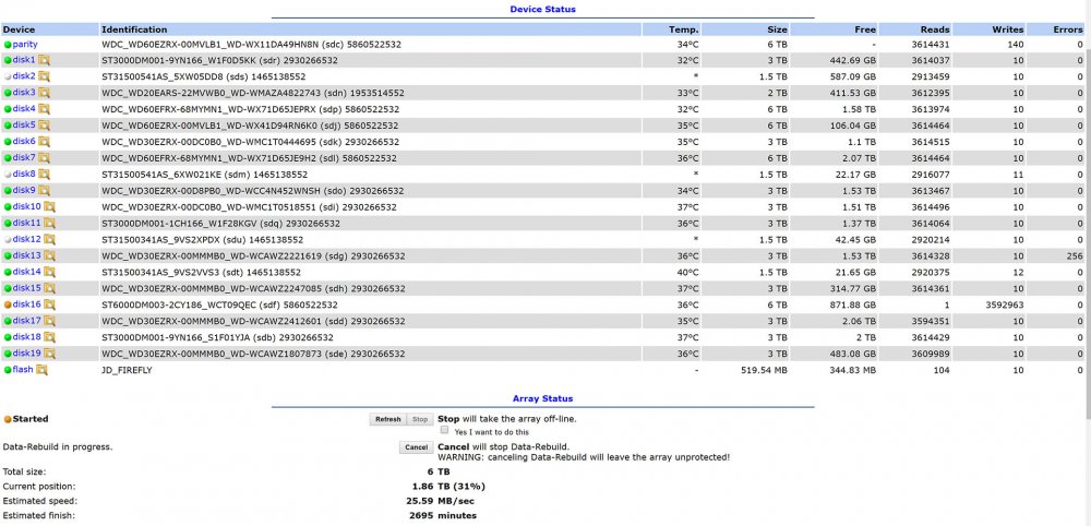

johnnie: I swapped disk14 and disk10's positions in my chassis and started another rebuild. So far, this one has been going okay, I think? There were a handful of errors on yet another disk, disk13, but I think those are sorted? I actually have no idea. I am 31% into the rebuild. I'm attaching a jpg and my syslog. Am I okay to allow this to continue? It has slowed down considerably and another odd thing is that even though my other 1.5TB drives have gone to sleep (because my rebuild is beyond their size at this point), the "trouble" drive disk14 hasn't yet gone to sleep. I thought that was odd. (Note: I'm about to go into work and won't be able to check in on things for about 11 hours or so).
And to jowi: My plan after this is to go up to a 12TB parity and then replace one of my 1.5TB with another 12TB, and then copy all of my other smaller, older drives' data onto that new disk. I am not in a position where I can easily dispose of the data that are on these drives. Yes, I should have paid better attention and should have replaced those drives earlier, but I am where I'm at right now trying to make the best of it. Do you really think I'm in an un-salvageable state with my data?
syslog_180328AM.txt
These will result on some corruption on the rebuilt disk, but since it's only a few errors let it finish, possibly it will only affect a single file, and only a small glitch if it's e.g. a movie.

The latest picture shows that disk 14 is ok agian? disk 12 is disabled, disk 13 has errors and disk 16 is redballed... damn.
I would never have swapped disks and performed a rebuild... if things go wrong now you are done. Your server is a disaster waiting to happen, it's got very old drives, you never maintained it properly. I run a parity check every month and check the smart status on a regular basis. I'm using 9x 4TB drives, it's been running for about 5 years now, i had to replace 2 disks already.
