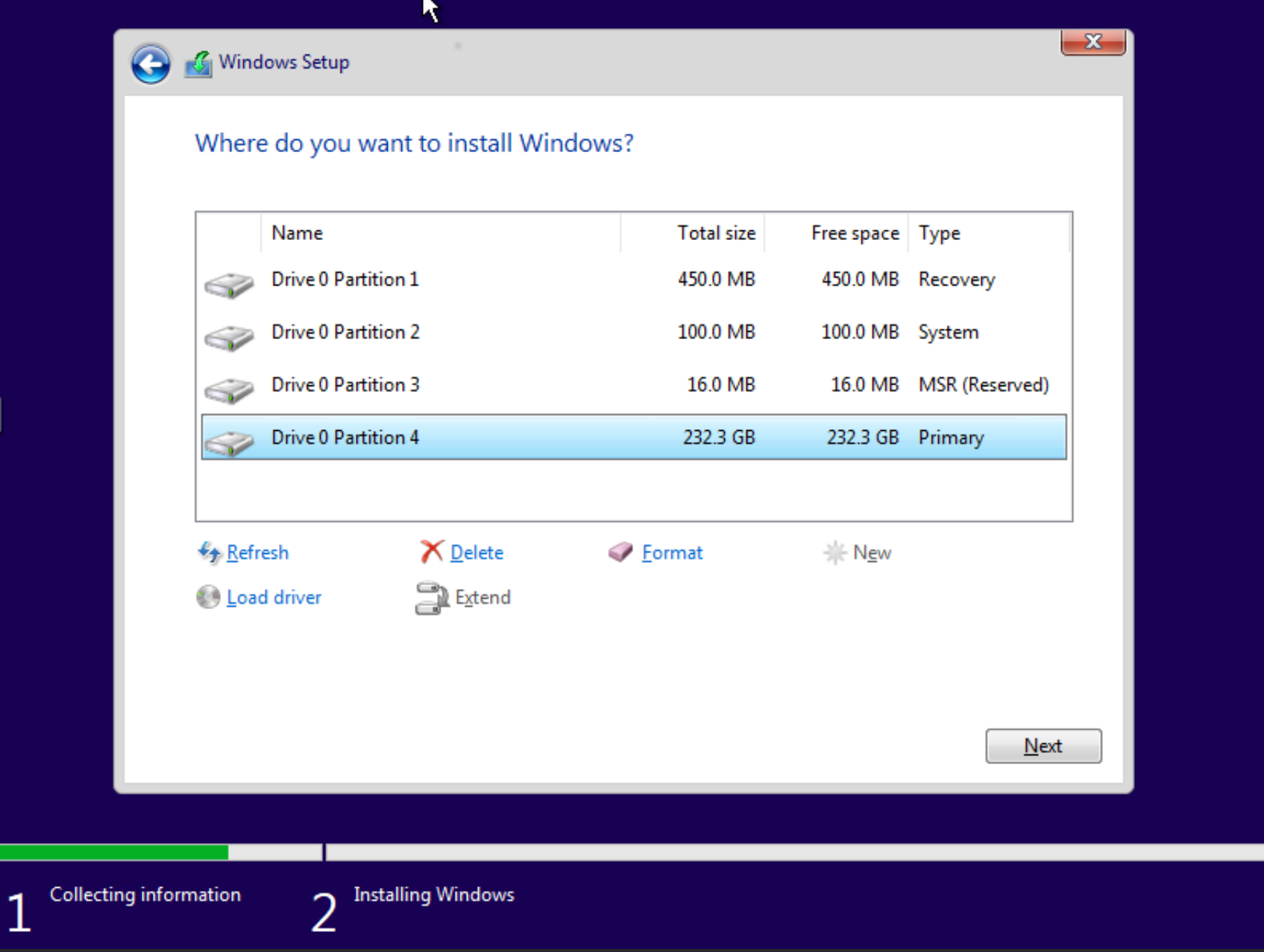

However, when i fire up the VM and Press a key for setup when prompted to, then clic through the several windows setup screens and load the virtio drivers, i see my ssd appearing:
This leads me to believe that my ssd and the windows installation on it are fine.
I could try to setup again my VM, but I'd prefer not to if it's avoidable.

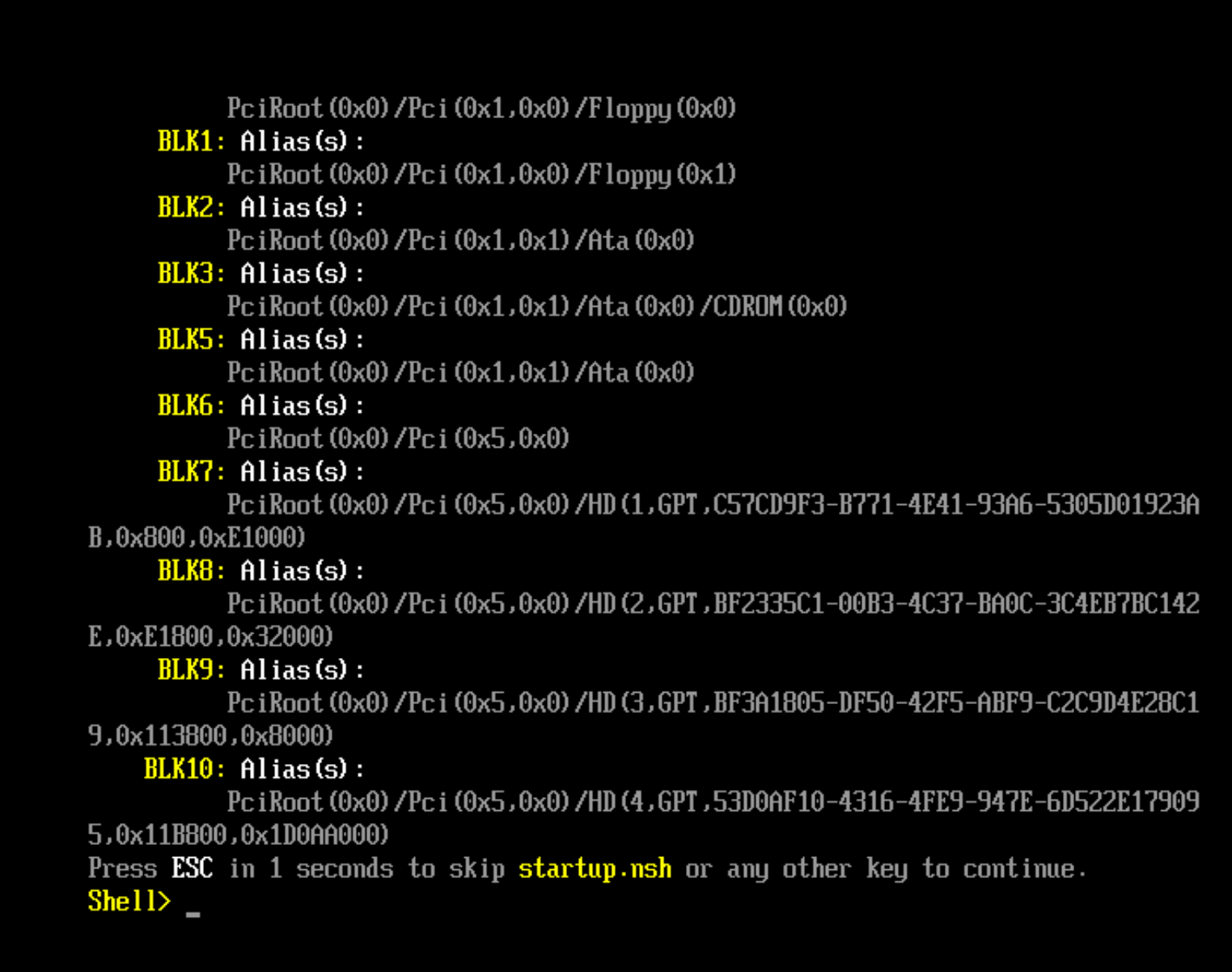

Try this here to change your boot device in the UEFI virtual bios:
Thanks for your answer!

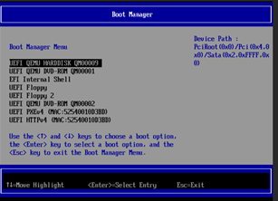

When I type exit in the UEFI shell and choose Boot Manager, i land on the following screen. I tried to select every of these items, but no success in booting my VM.
I read a few more threads and tried this, again with no success: http://lime-technology.com/wiki/index.php/UnRAID_OS_version_6_Upgrade_Notes#My_OVMF_VM_doesn.27t_boot_correctly
