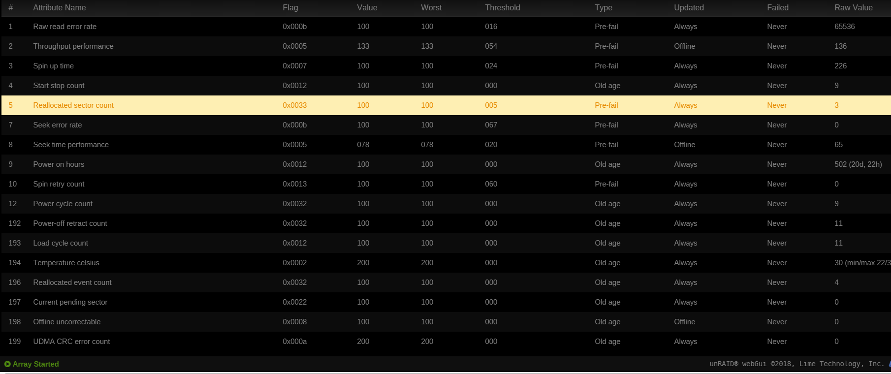

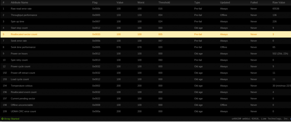

My disk has been acting very weird lately. 2 days ago this message popped up:
Event: unRAID Disk 1 SMART health [197] Subject: Warning [UNRAID] – current pending sector is 8 Description: TOSHIBA_HDWA120_679U9KHAS (sdd) Importance: warning
Along with this message:
Event: unRAID Disk 1 SMART health [198] Subject: Warning [UNRAID] – offline uncorrectable is 1 Description: TOSHIBA_HDWA120_679U9KHAS (sdd) Importance: warning
Minutes later current pending sector became 16 and few minutes later 24. Offline uncorrectable jumped up to 3.
After running parity check with correct unchecked I received this:
Event: unRAID array errors Subject: Warning [UNRAID] – array has errors Description: Array has 1 disk with read errors Importance: warning
Disk 1 – TOSHIBA_HDWA120_679U9KHAS (sdd) (errors 224)
No idea where the 224 errors came from, but whatevs. After running it again, this is the error it settled with:
Event: unRAID Disk 1 SMART health [5] Subject: Warning [UNRAID] – reallocated sector ct is 2 Description: TOSHIBA_HDWA120_679U9KHAS (sdd) Importance: warning
Offline uncorrectable and Current pending sectors went back to 0, but I was still stuck with Reallocated sector count 2. I've read on this forum that this warning is ok?
I decided to run yet another (third) array check, but with corrections enabled. 5 hours later nothing changed - still 2 errors.
I approved the reallocated 2 warning, but it has jumped to 3 during last array check and been sitting like that for a day with error below:
Event: unRAID Parity check Subject: Notice [UNRAID] – Parity check finished (2 errors) Description: Duration: 5 hours, 56 minutes, 6 seconds. Average speed: 93.6 MB/s Importance: warning
This warning does not seem to go away, I thought that reallocated sectors warning is not that serious? Yet parity check report says 2 errors, hmm. I am so confused as to what's going on..
I have brand new replacement drive same exact as this toshiba, cables disconnected. Should I go ahead, replace this drive with the new one and send the broken one back to amazon? I've only had it for 20 days. If so, what do I tell them? Send them SMART logs?

Pending sectors were reallocated, and currently they are relatively few, but never a good sing on a new disk, depending where you bought it, if you can trade for a new disk do it, if it's RMA only, at least run an extended test, since it might be OK for now and refurbished disks are a crapshoot.

Thanks for replies, guys. Extended test finished with errors (see attached), looks like HDD is indeed dying. Any tips on how to proceed? Should I just swap it like I'd normally do or do I have to be extra careful due to parity errors? It's only a PLEX server.

Num  Test_Description    Status                  Remaining  LifeTime(hours)  LBA_of_first_error
# 1  Extended offline    Completed: read failure       70%       504         942107520
SMART test failed, so it needs to be replaced ASAP.
