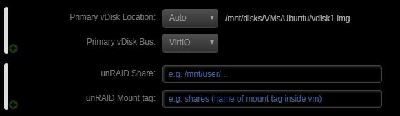

But the Ubuntu template doesn't show vdisk size. Does that mean that it will grow with the VM?
The vdisk size has already been set (when you originally created the VM)  To change the current size, you  do it by clicking on the name of the VM and then you can change the size of the disk . (6.4 or 6.5-rc3+)
You can (at least on a Windows setup) also create a VDisk that will enlarge and shrink according to the actual disk space used by editing the XML appropriately (see the VM FAQ)
