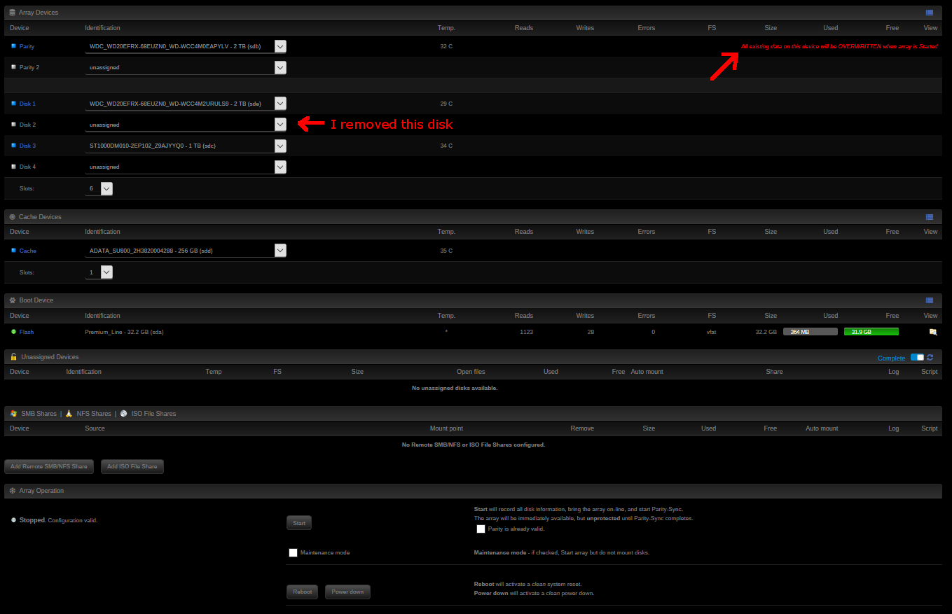

I took a screenshot, I re-assign all drives and I'm scared to start the array because the error " All existing data on this device will be OVERWRITTEN when array is Started" shows up. So what does this mean to me? Do I have to reinstall all dockers and plugins?
Sorry this is a new scenario for me :/.
Parity will be re-synced at array start, and it's needed since you removed a disk, but data on the array disks will remain unchanged.

Oh man Johnnie I thank you so much!!!! Everythink works fine <3. You saved my day!!!

8 hours ago, CreZo said:
I removed an old drive (500 GB) from the array
That drive was empty, correct? Any data that was on the drive is now gone if you sync parity to the new disks. Any data on the other 2 array drives will be fine.
