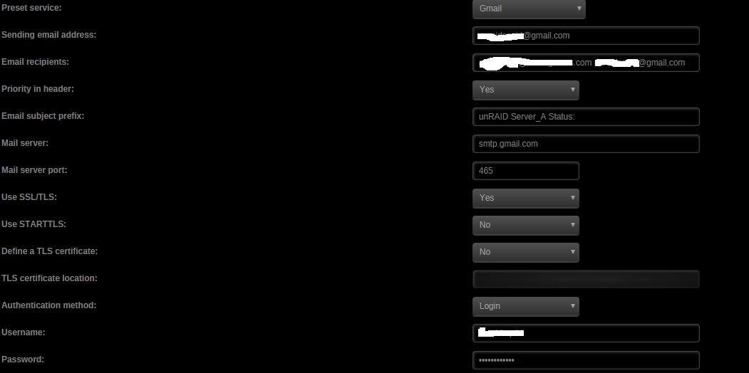

I'm seeing a lot of users reporting bad disks and as part of the support response being advised that they really SHOULD have notifications switched on in advance. I've not done that so far and been trying to set up emails via a gmail account. It's just not working for me ... authorisation failures. Now i KNOW i am inputting the right details, just maybe in the wrong order [emoji2]. Can anyone enlighten me as to what goes where and if i'm still totally at odds which is a good, reliable agent to use instead?

Did you set up in gmail the "allow lower security apps" or somehing like that.  Can't remember exactly what it's called.
I had to go into my G-mail acct settings (Sign-in & Security  >>  Apps with account access ) and turn on "Allow less secure apps:".
Yeah ... enabled less secure apps earlier but still getting authorization failed messages.
Sent from my LG-D855 using Tapatalk
Thanks!
Sorted ... I was repeating my full email address instead of just 'username'. What an eejit [emoji38]

That's one way.  I just put the server name in the "Email subject prefix:" setting on the SMTP Setting  tab.  That provides me with the server name in the subject line of every E-mail. That way I can use the same E-mail account for all servers.
