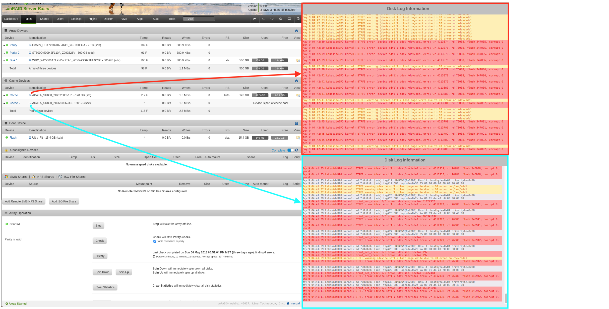

Cache Disk Errors
Can someone please help me understand what these errors mean and how to fix them? As far as I can tell I am not loosing any data but I would like to resolve this as soon as possible please. These errors are constantly happening right now. Thank you!

Also, I don't know if I was getting these errors before I added the second ssd to the pool. I just added the second ssd a couple of days ago and that's when i noticed these errors.

Unfortunately the syslog doesn't show the start of the problem, but looks like sde (cache2) dropped offline, you'll need to power down, check cables, and if it comes online run a scrub on the pool, make sure there are no uncorrectable errors.
I swapped out the sata cable and this is what is happening now. not as many errors but a couple and a warning. I haven't done a scrub yet. What should i try now?
