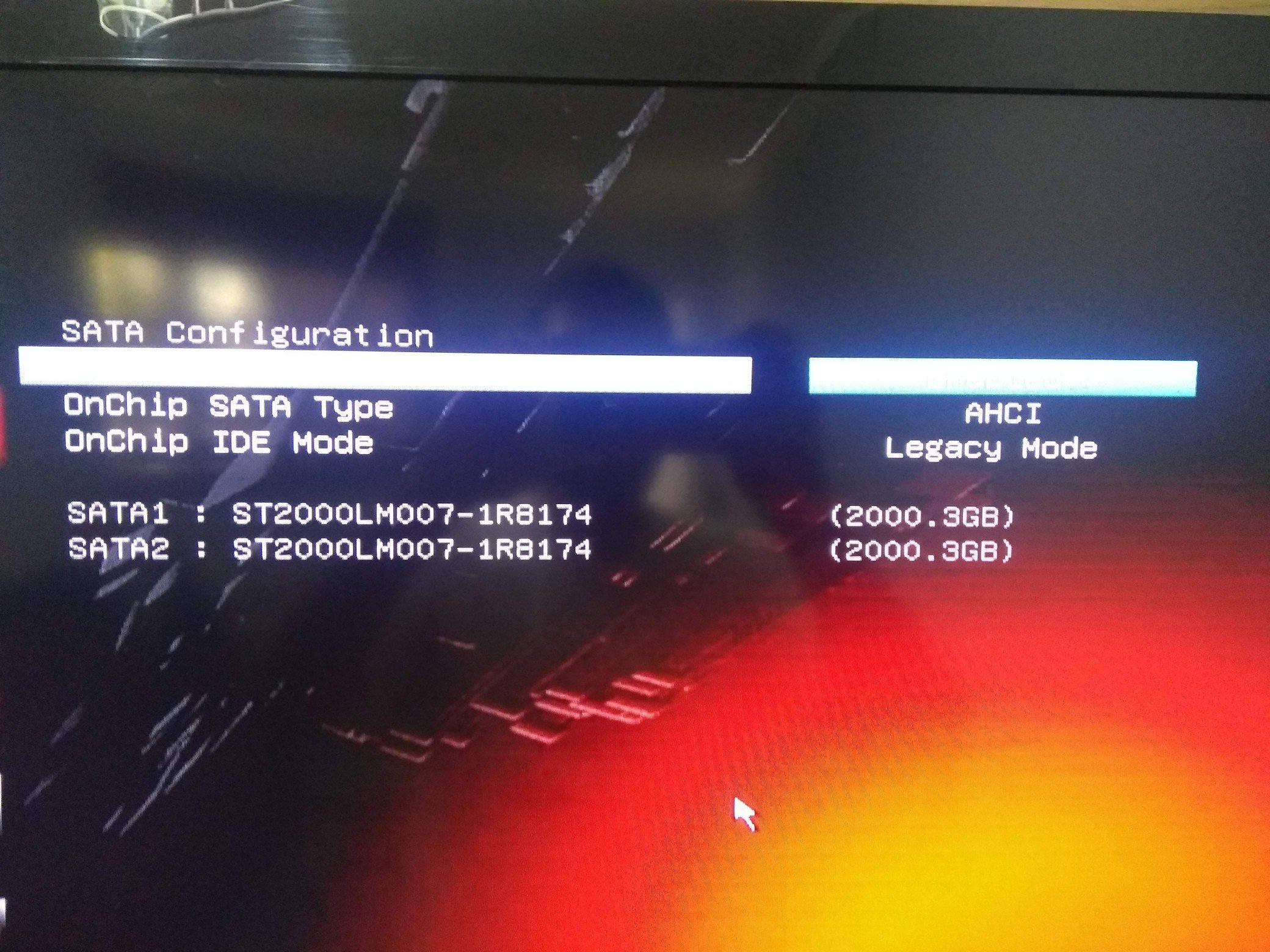

My mini ITX mobo I have, has 2 SATA 3.0, where I connected 2 HDD of 2Tb to be used as "disks"

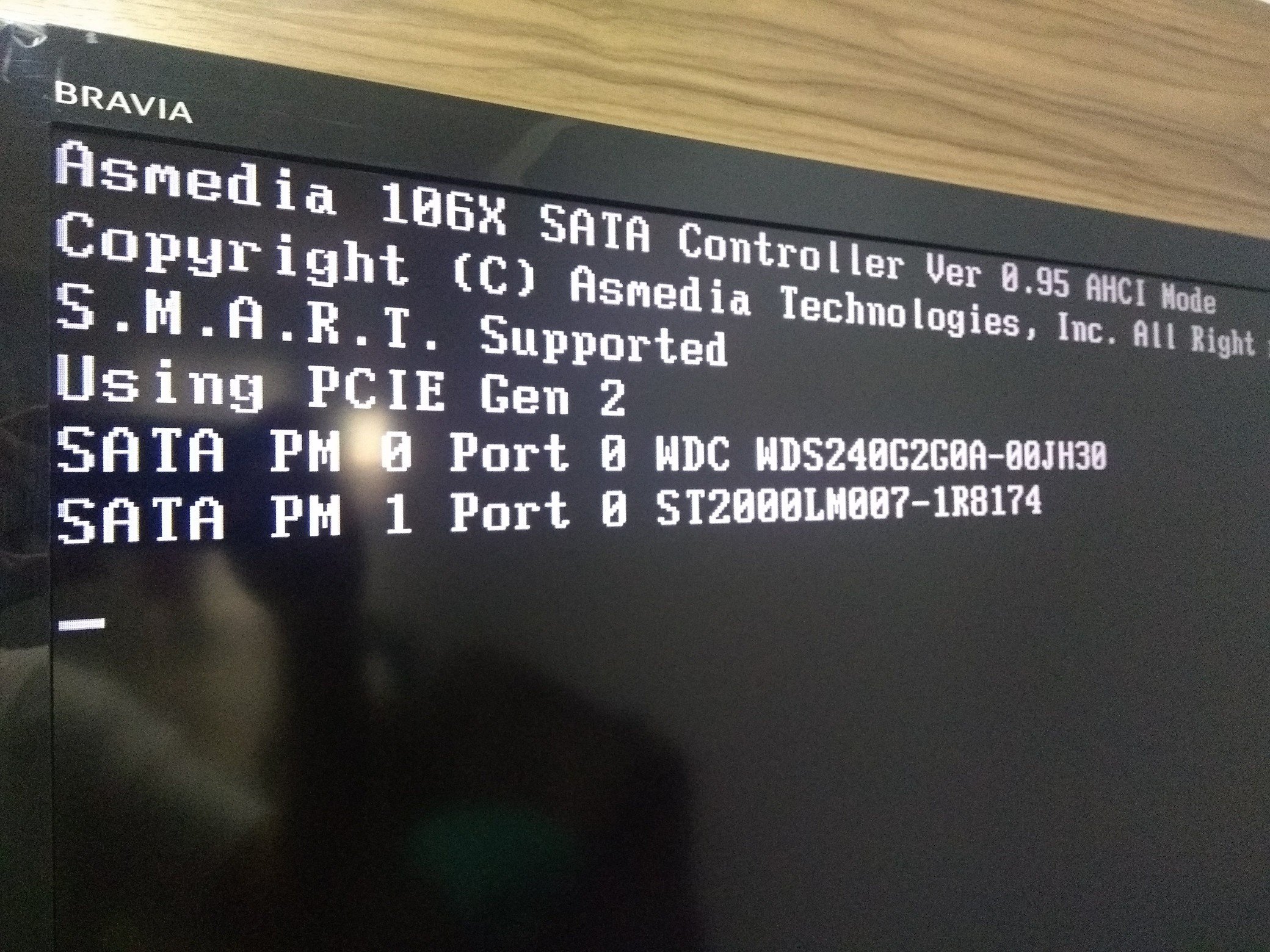

The PCI Express Expansion Board is based on ASMedia ASM1061.

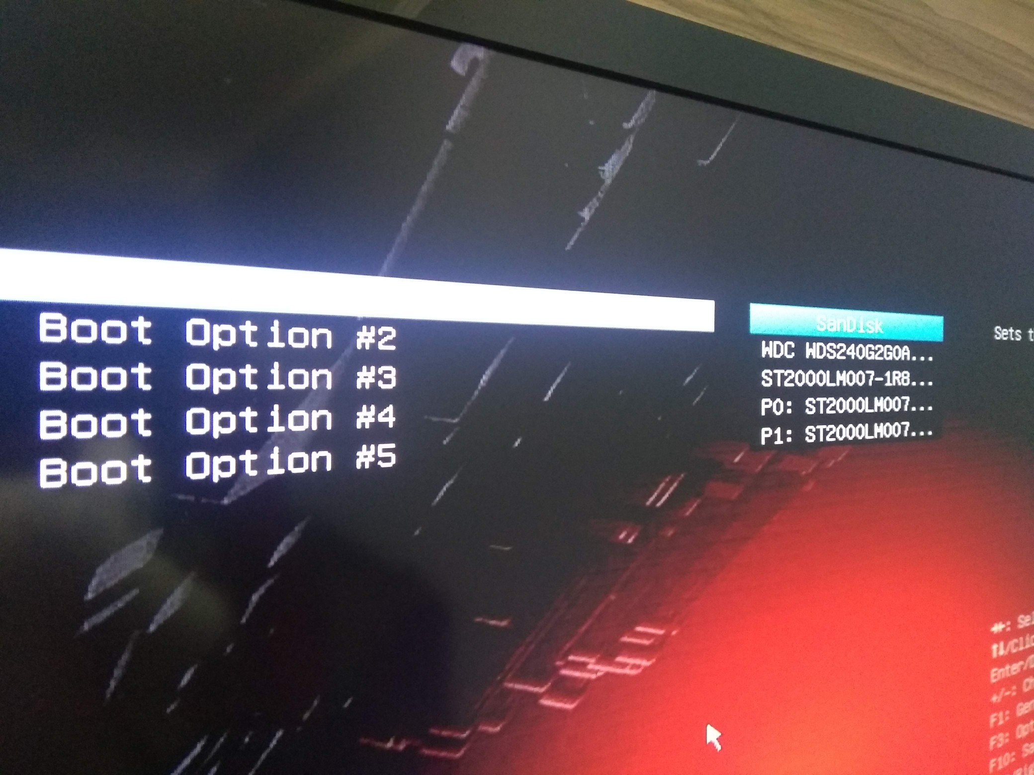

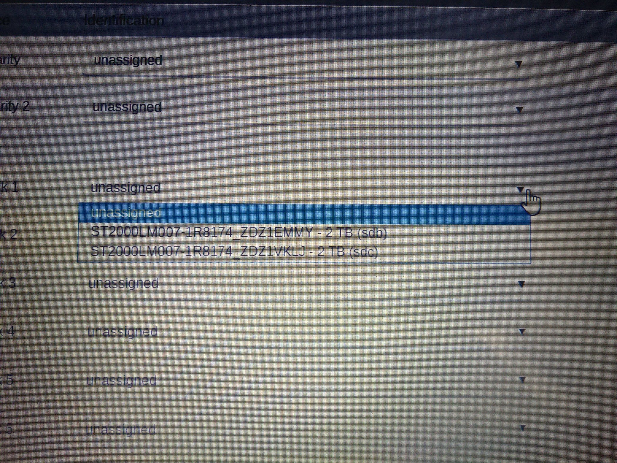

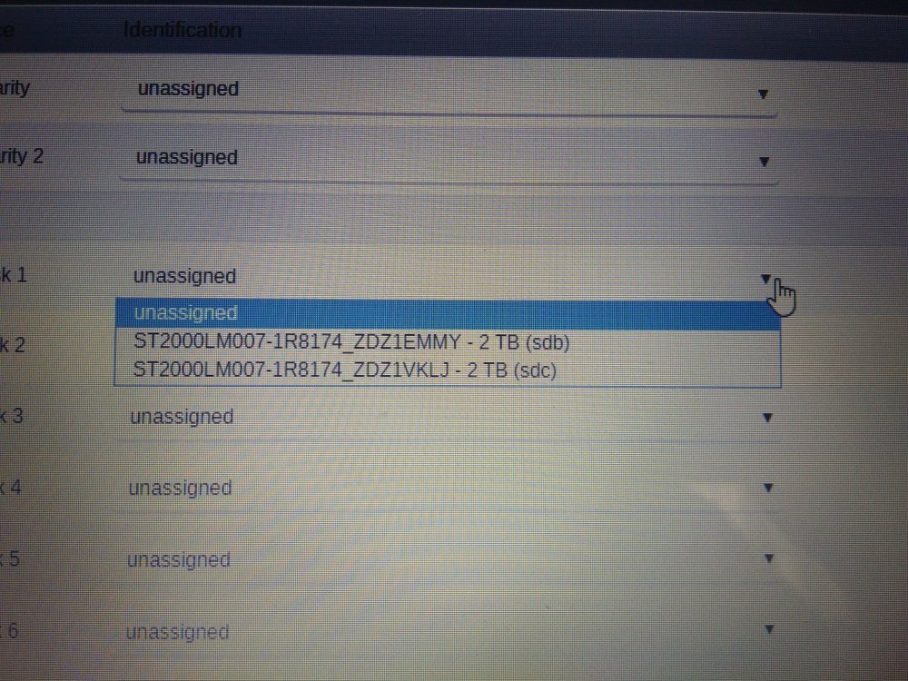

The problem is: I can't see the "parity" HDD and the "cache" SSD...

The Asmedia 106X is plug'n and play with unRAID, no modification necessary, your log shows problems identifying both disks on that controller:
Jun  3 04:47:02 L3K-CLOUD kernel: ata3.00: device reported invalid CHS sector 0
Jun  3 04:47:02 L3K-CLOUD kernel: ata4.00: device reported invalid CHS sector 0
Either there's a problem with the controller or some other compatibly issue, since it's a mini ITX board there's no other slot you could try, so not much you can do, look for a bios update, if there isn't one or it doesn't help you'll need to try a different controller.
