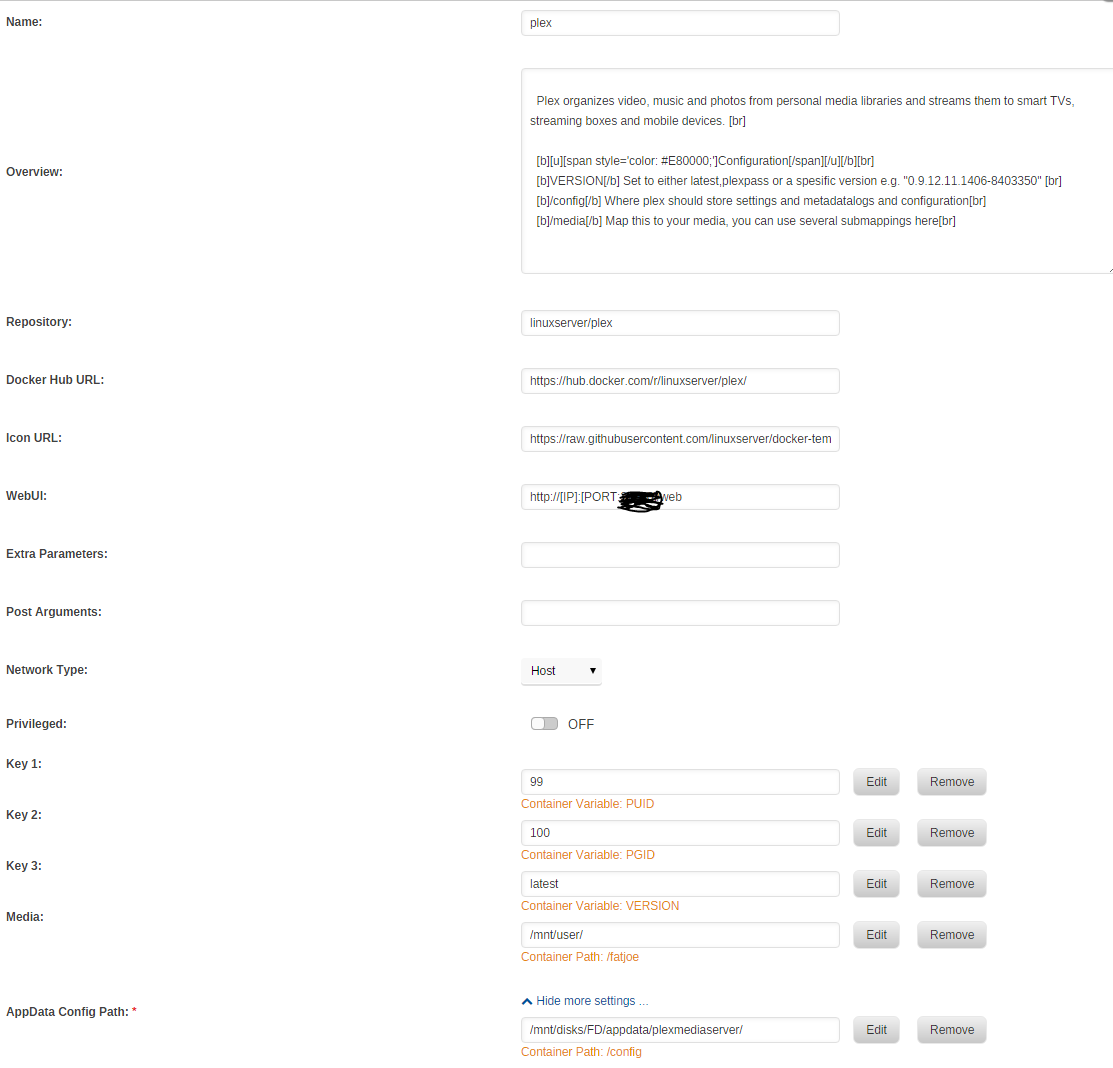

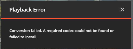

hi group i've been to the plex forum but it seems like its an issue with my servers docker setup. on certain devices i get the following error
i've read thread setting up a HD location for this and some others mentioning that its done in RAM.. can someone look at my config and lend a hand as to which way to go?
I don't see a path setup for transcoding in the pic

i've seen that mentioned in other threads but i dont have it.. is it a field that users put it or is it suppose to be from the docker install? can you share a screen shot of yours.

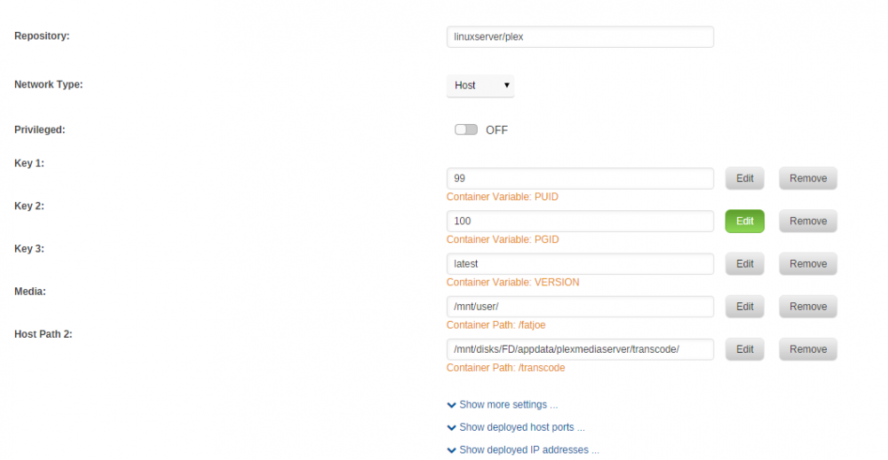

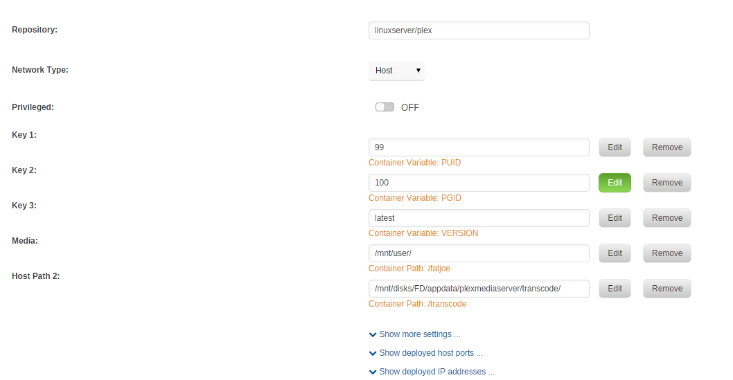

I use the official Plex docker but this is how mine is setup. I have my transcode path on a unassigned disk. I had it setup on RAM(/tmp/) but I found watching live TV would fill up my RAM.10eb8aca32d2480946ea840e4db64d95.jpg

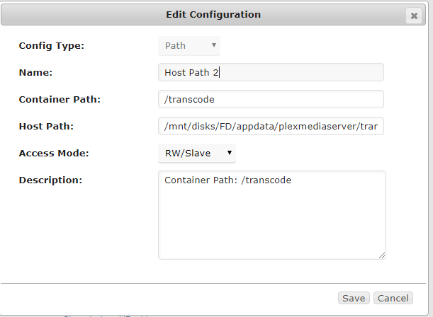

thanks for the screen shot.. i've add it in there but it still wont transcode :/

i can see the codec being downloaded but some still not transcoding.
