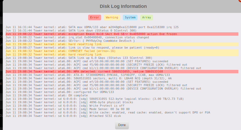

Unasigned device disk log shows HPA detected

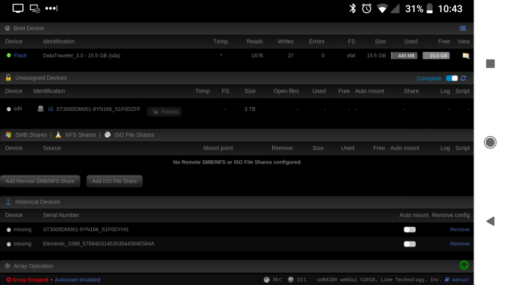

Can't mount old array data disk in unassigned devices. To move to new array. Any assistance much appreciated :)

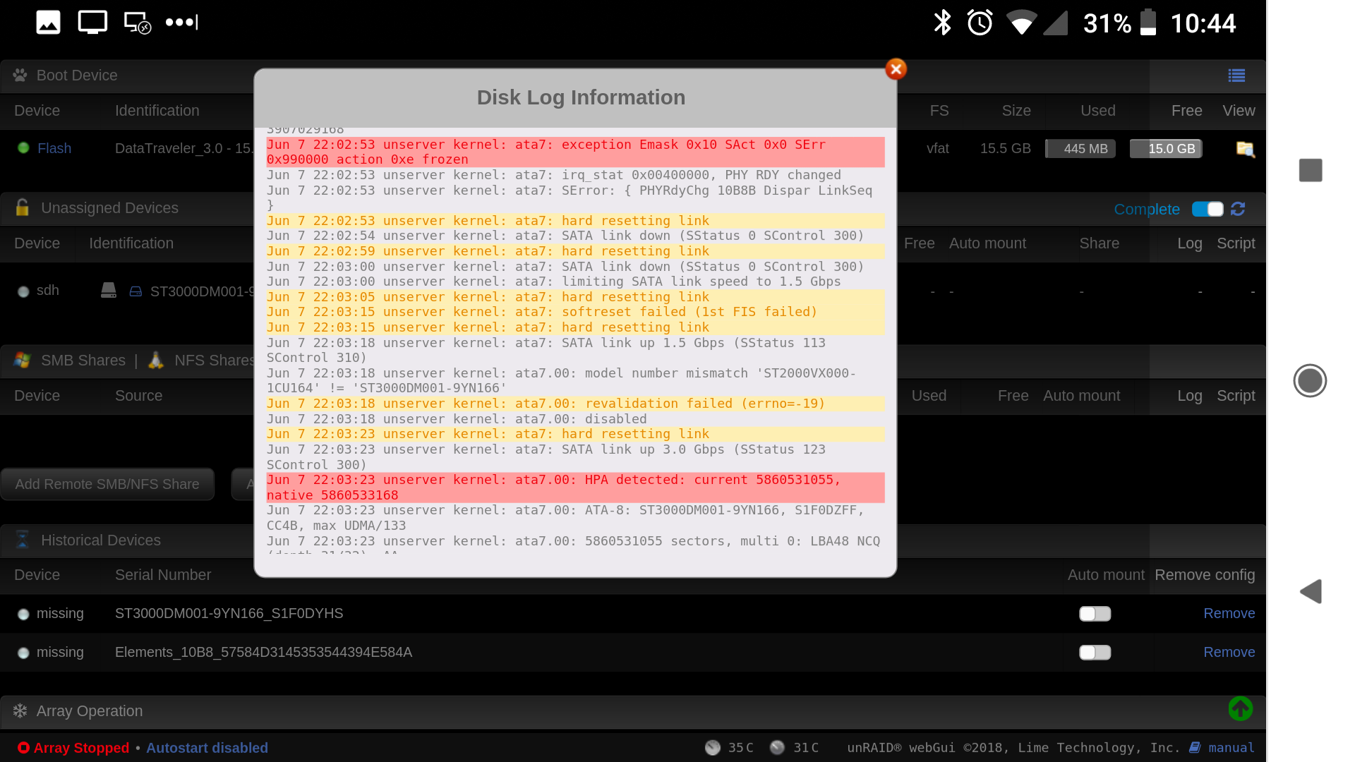

Log.PNG.c8edf85a37e2c9666bccd9560068aca1.PNGhmm so i have a brand new Hardware/config Unraid server and im still unable to mount the xfs disk from my old Unraid box :(. would this have something to do with HPA or is it just a coincidence?
Any help on this is much appreciate as data on the disk is important.

The HPA should be irrelevant as far as mounting it.
it is possible that there is some sort of file system level corruption and you need to run xfs_repair to fix this.

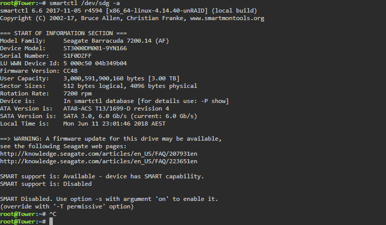

Those ATA errors indicate a connection or disk problem, can you post a SMART report for that disk?
not sure i can. from the GUI. Does this info help? seems SMART support in disabled... im sure the disk was fine when in the array running for 2 years. should i enable option -s?
To enable type:
smartctl -s on /dev/sdg
If you decide you must run xfs_repair against the device rather than the mdX type device then you need to include the partition number(e.g. /dev/sdg1).   Note that running xfs_repair against the sdX type devices rather than in Maintenance mode against the mdX devices) will always invalidate parity.
