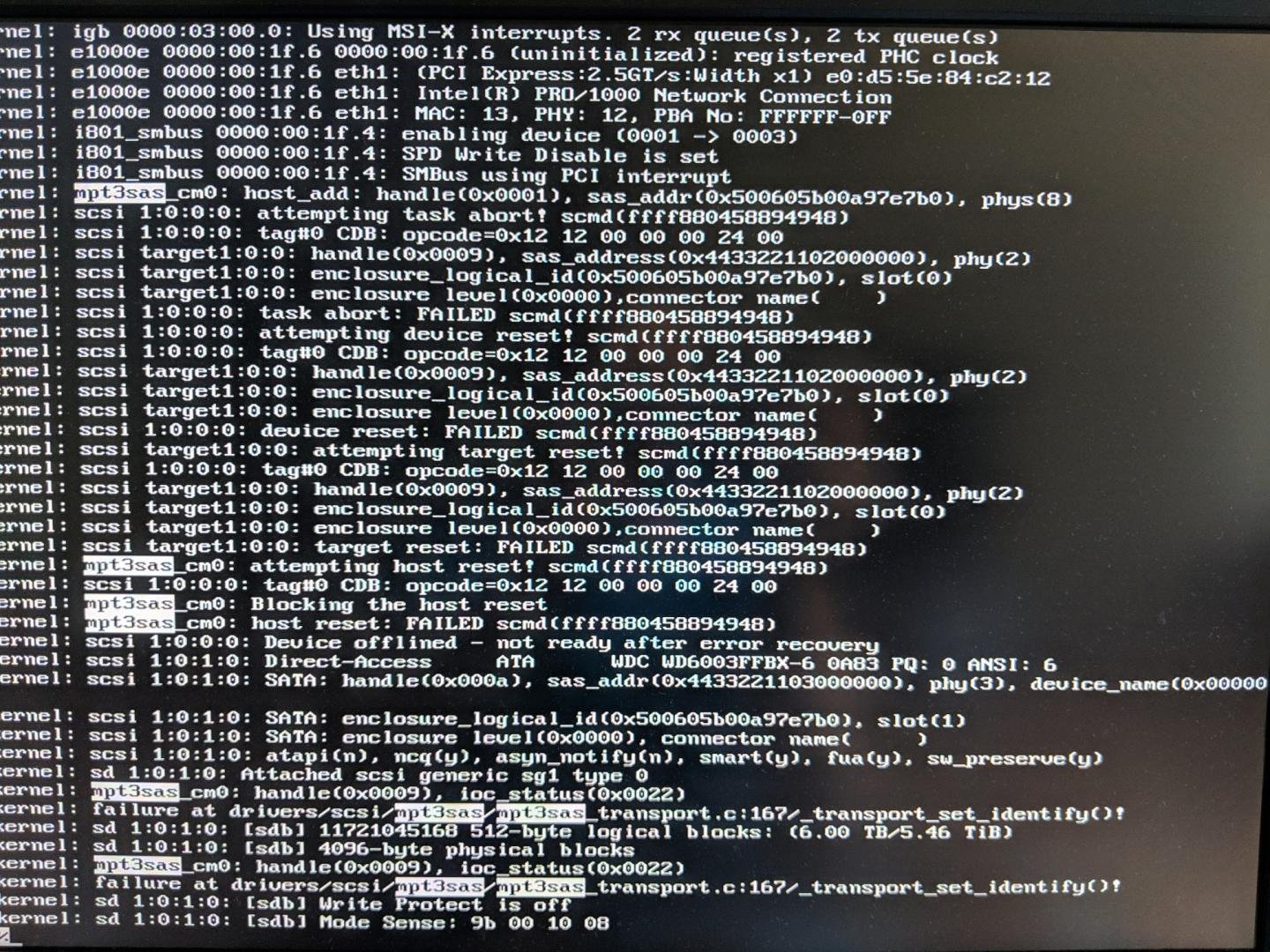

Enabled Legacy Bios in the UEFI menu, then forced the Legacy BIOS under the CSM support settings, and I could get the card to boot in a reasonable time. Attached is a screenshot of the syslogs that appear when the drives are being detected. The logs are with two disks attached.
Thanks for any information you can give.
Edited by Pengy
Adding logs
