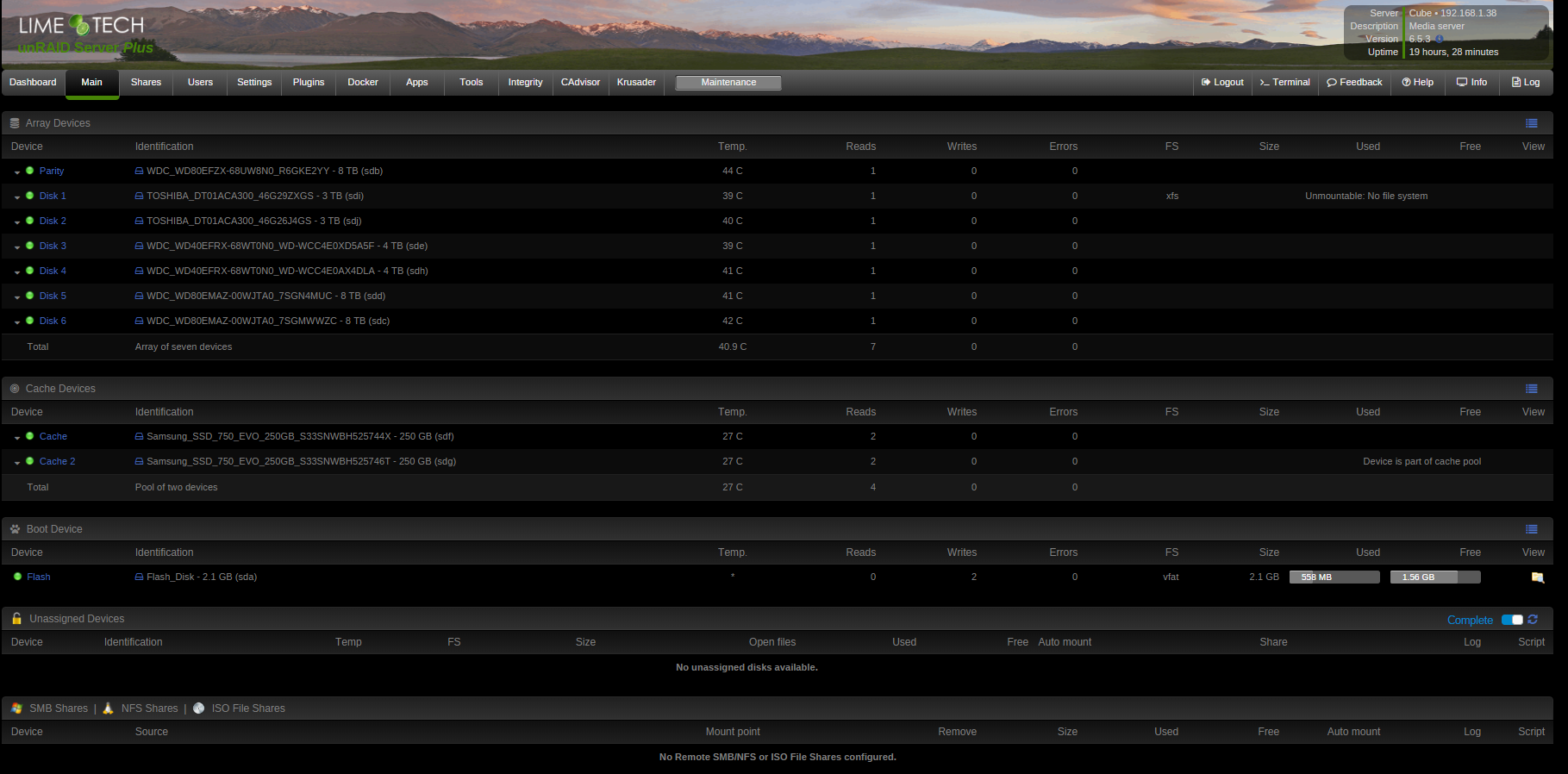

Hi, I was previously having some issues with one of my drives throwing a bunch of errors which I believe to have narrowed down to being caused by faulty cabling which seems to have been fixed now. But while the previous issue was ongoing the server would not gracefully shutdown, so I have to force power it off, leading to the unclean shutdown. I opened it up and reseated the offending connectors and now on reboot the drive the was previously causing problems (md4) seems to be working fine, but now Disk 1 says "Unmountable: No File System". (All of the array drives use xfs)
I've attached a pic of the dashboard showing the issue with the array in maintenance mode as well as the server's diagnostics. The first thing I will do when I get home today is to go back in and check the internal connection to make sure I didn't accidentally bump anything in fixing the initial problem, but since I don't think that is the issue I wanted to ask here for any advice on what my next steps should be. I'm not sure how recently the last successful parity check was, but it would have been a least a week or two. In any case, it would have been before the issues I've described here and since I've had unclean shutdowns the parity is prompted to rebuild when the array is started, which I have not done as of yet.
