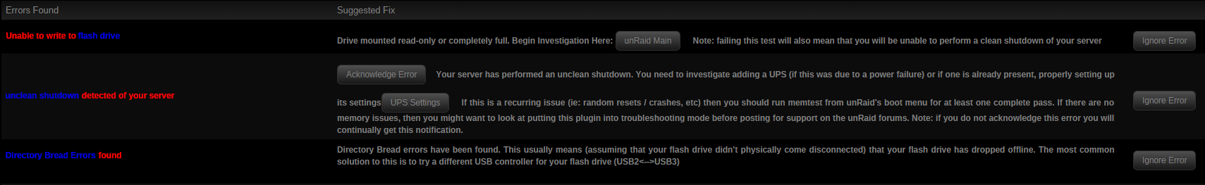

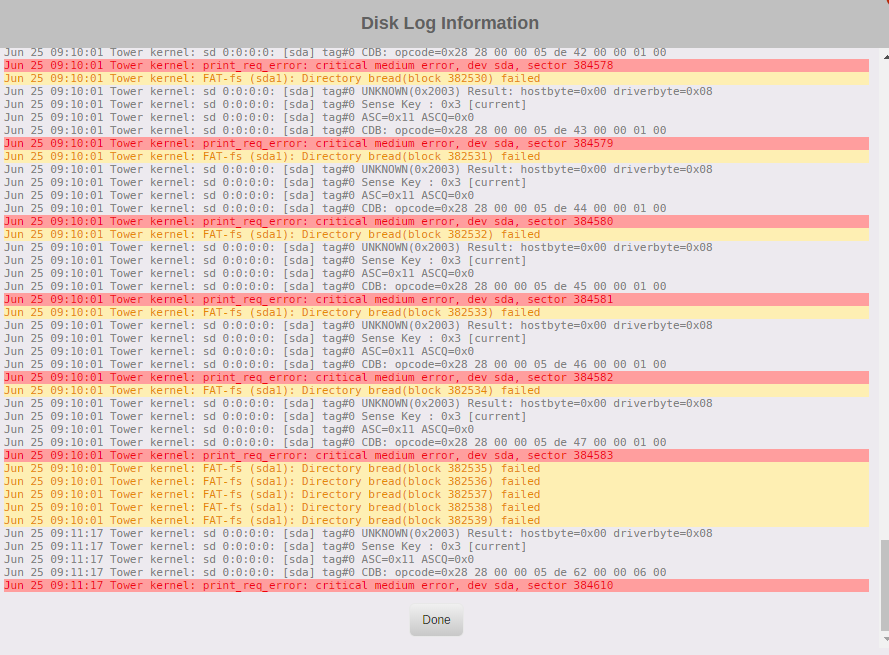

Hi guys, this morning I first received Error message on my Unraid Build and I think my usb is failing.
here my usb log and my "fix common problems messages".
What should I do? I stopped the array, copied the /config folder (except one file wich gave me error) and started back my array. Starting it back made begin a parity check.

Have you looked at the report you included?   ..and what are your findings?
Have you checked the flash drive to make sure it was not full?  (If you have more than 1GB on that flash drive, I would be suspicious that you have a Docker/Plugin setup wrong and it is using the flash drive for storage!)
Have you checked to see what kind of USB port the flash drive is plugged into?  USB2 ports (black plastic insert) tend to be more reliable for unRAID boot drives.
You should also post up a Diagnostics file with your next post.    Tools   >>>>    Diagnostics
EDIT:  Also run chkdsk  on that flash drive  in your PC and see if there are any errors.

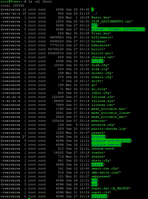

By the way, the  Linux path to the flash drive is     /boot    That is what you should be looking for in the configuration section for each Docker, plugin and VM as a complete path is required.  If you PuTTY (using SSH)  into your computer, you can see the contents of the root of the flash drive with this command:
     ls  -al  /boot
You will get writes to the flash if you update your Dockers and plugins.  Both of these store their configuration files on the boot drive so if you make any configuration changes, you would probably have a write to the flash drive.

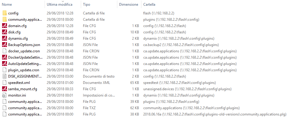

This is the result of the command & a search from win in the usb folder with file modified "today". Can you see something strange? this morning I had 285 writes, now it's 382 :'( I made some changes in settings but I don't think I did 100 changes!
Well, you did update at least one plugin.  (community.applica...)  plus changes to seven configuration files (.cfg).  I am unfamiliar with speedtest app...  You appear to have a lot of stuff that you are doing automatically on a regularly scheduled basis.  Any time, you make a change as to how your server is setup, you are going to have to store those changes somewhere and that will result in most cases with a 'write' to your flash drive.
