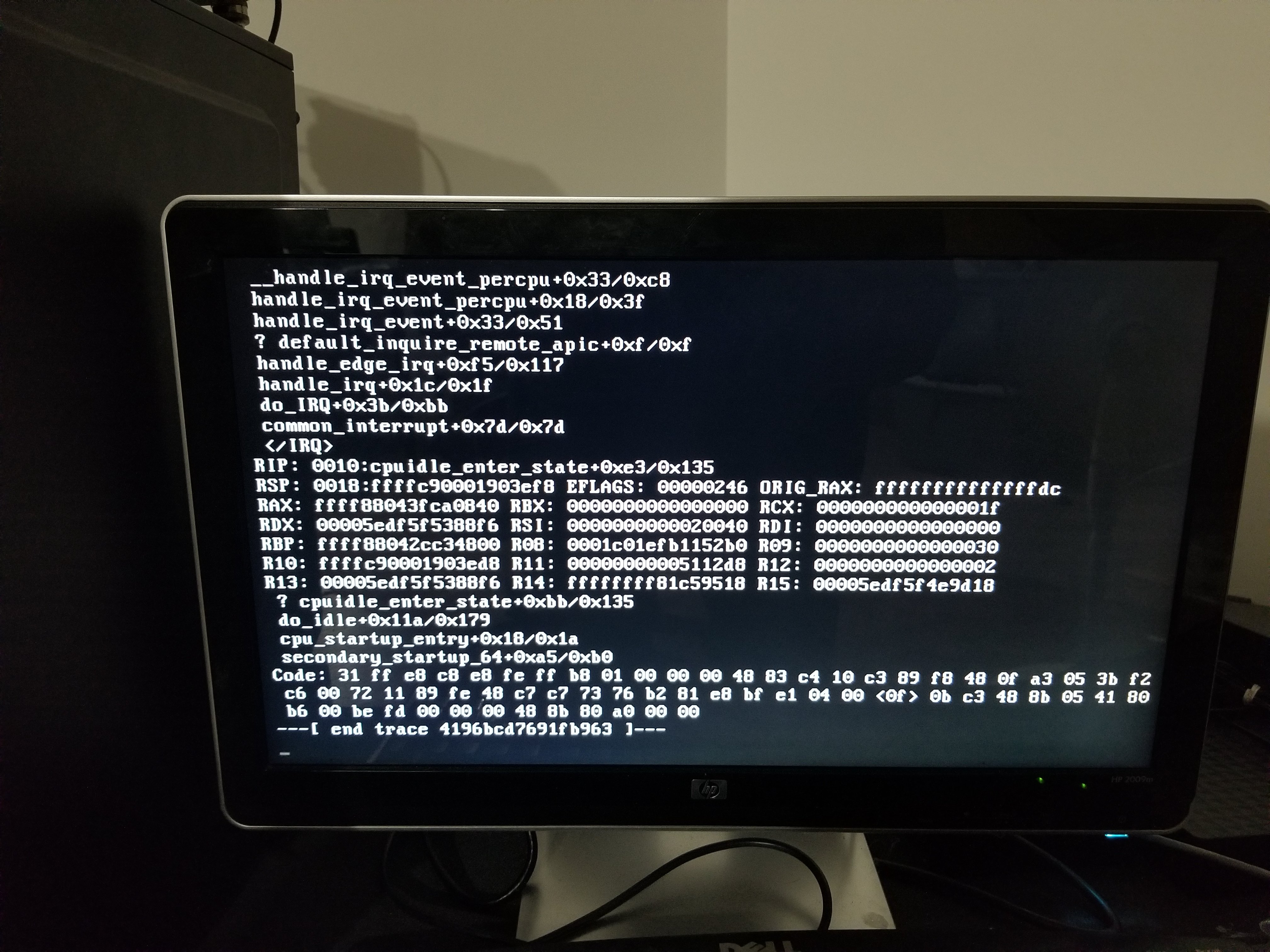

June 26, 20188 yr Hey guys, I am trying to help a buddy out who is new to unraid and we just set his system up. For some reason out of nowhere the server just drops off line and loses all function. I took a picture of what is on the screen when I come down to it after this happens. Also I have attached a syslog and diag as well. I tried to look over it but to be honest I don't really know what I am looking at. Any help to try to narrow this issue down would be appreciated. the server is nothing crazy, AsRock MB Amd Fx 9590 16gb Ram OS runs on 8GB Sandisk Mem stick wakanda4eva-syslog-20180626-0045.zip wakanda4eva-diagnostics-20180626-0059.zip Edited August 13, 20188 yr by tmoran000

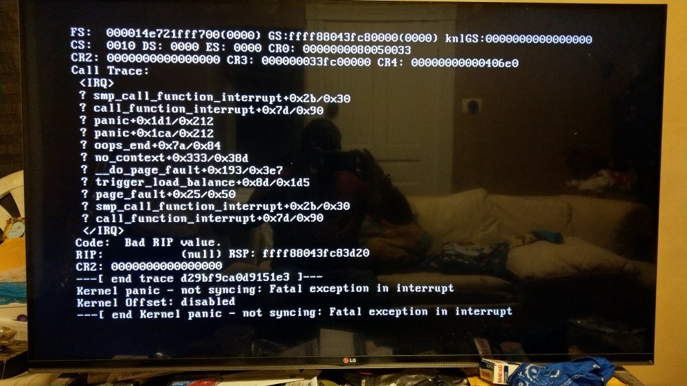

July 22, 20188 yr Author ok so again same as before. random shut downs on anything cpu intensive... there is a new screen showing.. maybe this can help someone help me with this.. . wakanda4eva-diagnostics-20180721-2306-2.zip
August 13, 20188 yr Author Update**** It turns out that it was a bad CPU causing this to happen. I replaced the CPU and it resolved the issue totally.
