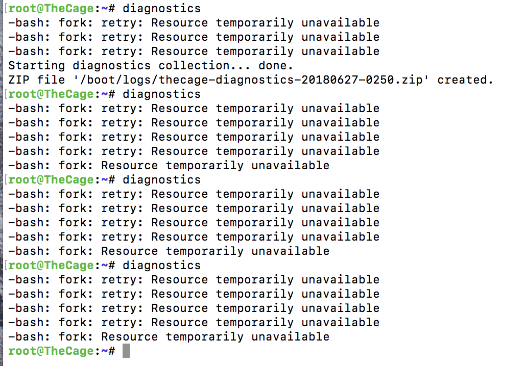

JonahJ Posted June 27, 2018 Author Share Posted June 27, 2018 5 hours ago, johnnie.black said: Two of your disks are on a Marvell controller, though they don't usually lock up the server they are not recommend with unRAID, if you can try again without using it. It's been working fine with the card for a few months now. Also it's locking up even without a parity sync, only thing I'm doing on the server is running a "badblocks" planning on going down each drive one by one. If that doesn't work maybe a downgrade. Unfortunately it's difficult to get output from the box, screenshot below of the forking not working while trying to get diagnostics. Link to comment
