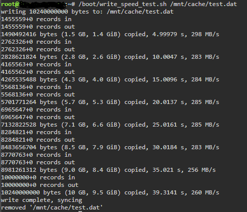

You can use the attached script to test the server raw write speed, without involving the network, copy to your flash drive root and use like so:
/boot/write_speed_test.sh /mnt/cache/test.dat
write_speed_test.zip
Here are the results:
This confirms, like I mentioned, that the problem is the network, if it's the server NIC, cable, switch or source PC I can't tell you, you need to test and rule things out.
