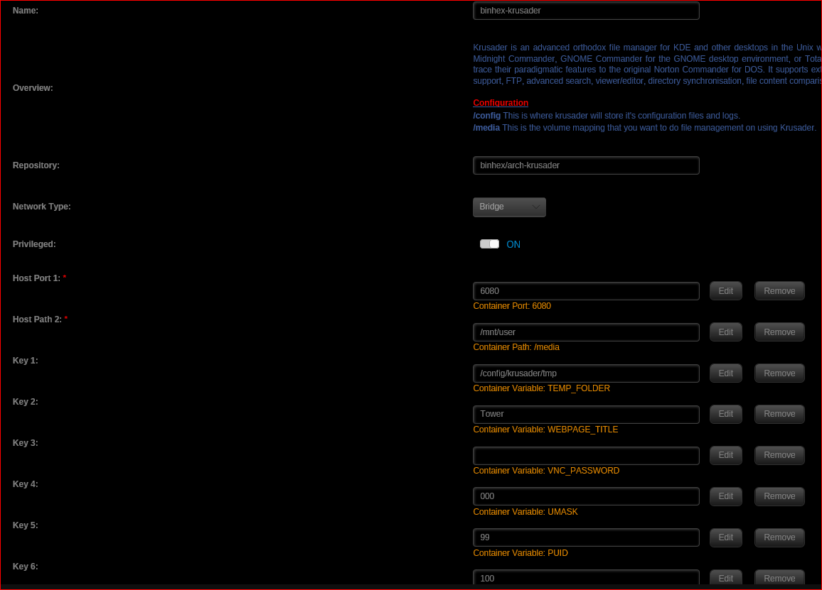

July 15, 20188 yr I am running 6.5.3 , I have notice when installing or editing a docker app Host Path 1 is missing in all app configs, my other older 6.5.2 server still has Host Path 1 in all the docker apps config. Any suggestions Thanks
July 15, 20188 yr Not without screenshots. Host path 1 does not have to be there an any particular app. It's what appears if the maintainer doesn't bother naming the pathSent via Tapatalk because I'm either at work or enjoying the summer
July 15, 20188 yr What you're seeing is correct. There are only two paths being passed through to the app. It's appdata (which you can get via the Show More Settings), and the /media path (which is unlabelled, so it's being called Host Path 2). Presumably, when binhex created the template, he added the /appdata path first, then the media path (which is why its host path 2), and didn't bother renaming it so unRaid leaves it at the default of host path 2.
