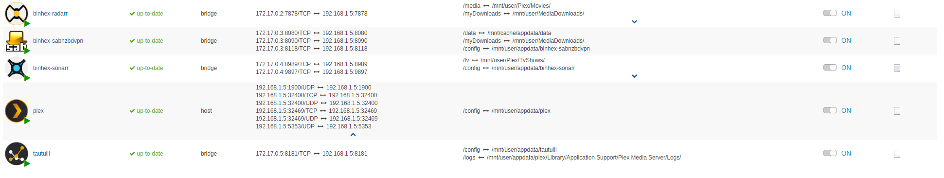

Screenshot attached of Docker screen.

I still have different IP's from other dockers as in the image above which makes no sense to me and I have to reshare all of my libraries to friends.
