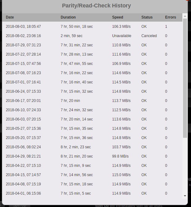

I can also confirm this because i have done this in the past. Just yesterday i deleted an empty share folder from a disk that was not assigned to said share then ran a parity check. 7 hours later the check completed and corrected 1 error.
You must have had some other problem to cause the parity error as doing operations on /mnt/disk1 updates parity.
