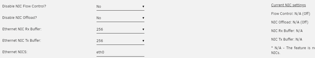

I had the same problem (no ping to 8.8.8.8 possible, but local access works). Finally I found out that the Tips and Tweaks Plugin killed my network settings. I do not know why, but after removing the "eth0" of the list and rebooting the machine, the internet was accessible again:
I think the plugin is overwriting my settings on boot causing this error. I will post this in the plugin's thread, too.
EDIT: Sometimes even the local network did not work. If this happens it helped to login through the server itself (IPMI or physical) and after log in with "root" and my password, I used this command to re-apply the network settings:
/etc/rc.d/rc.inet1 restart
After that I was able to open the webclient again.
