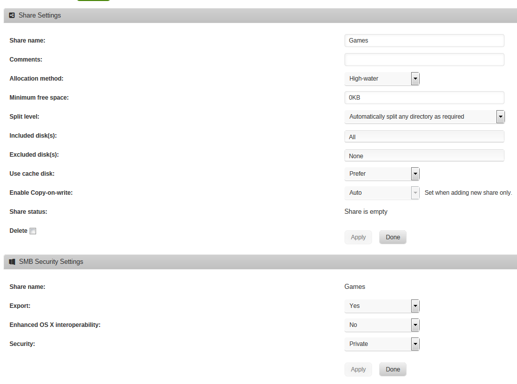

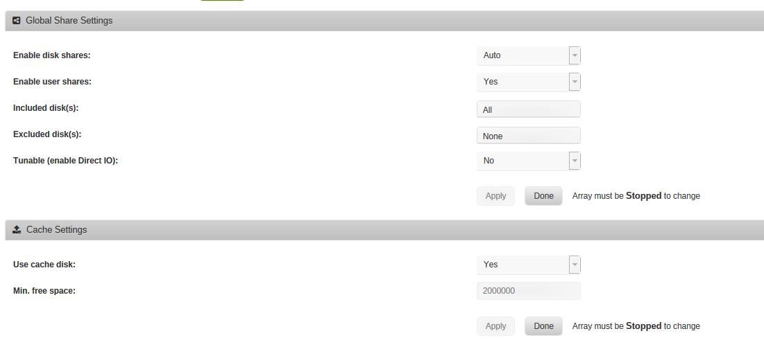

--------Cache Setup--------
1) I have added the cache
2) I have enabled the caches
3)  have set the setting to prefer on shares

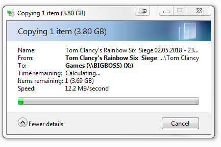

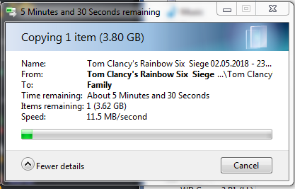

--------Test I've done --------
Transfer 3GB Video File
Folder 1 - Games (perfer cache settings)
12.2 MB/second
Folder 2 - Family (no cache setting)
12.2 MB/second

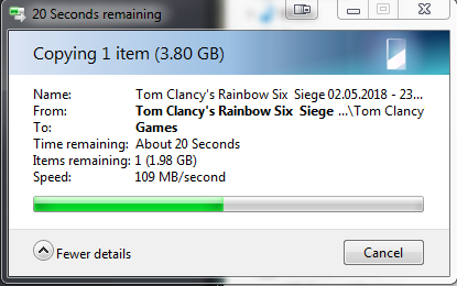

Just to update and for future reference with anyone with a Killer NIC.
The cheap £10 one works!
I did order intel one aswell so will do a test with that to compare to see if it makes any difference.
I would recommend the UGREEN-Gigabit-Express-Network-Ethernet  for a quick fix if your current onboard Ethernet NIC doesn't work with Unraid.
I'm glad you're happy with your purchase :) That's a massive improvement.
