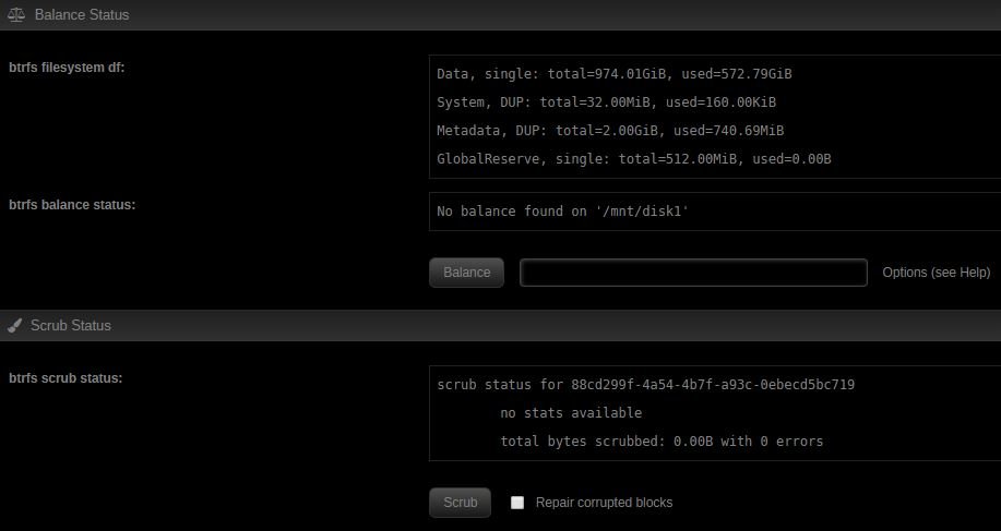

I'm in the process of converting the the metadata now before I copy my data back over.  I just wanted to check if this looks correct now after I run that command.
Yes, this way all metadata is duplicated, it uses very little extra space but if it get's damaged by an I/O error or similar the other copy will automatically be used.
