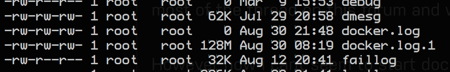

Another piece of info...I also noticed that Fix Common Problems was reporting that "/var/log is getting full (currently 100 % used)" so i looked in there and saw that I have two docker log files one of which is 128M!
It also seems that most of that file is showing the same error over and over

whats strange is that i don't have a container at that path?!?
Any ideas.... can i just delete that docker log?

You will probably also have to reboot to clear up the /var/log.

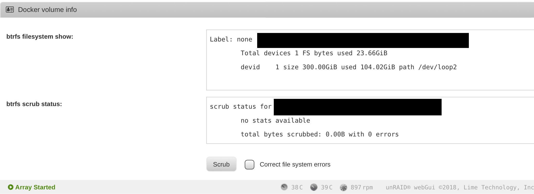

Is there a way to tell how much of the allocated 300GB Docker is actually using? Looking at the advanced Docker settings i noticed something that there are two mentions of 23GB used and 100GB used. Is either of those the size of what’s actually being used within the image?
Does that mean i can safely disable Docker, change size to say 30GB, and re-enable? Not sure if I’ve fixed the problem but I have deleted some older dockers and added the global log cap for all Dockers as described in the Docker FAQ.
Is resize the same as delete and recreate? You should delete and recreate.
