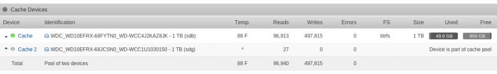

Last week I upgraded my cache settings from a single cache drive to a dual cache drive (included snapshot). That view makes it look like the second drive is idle and sundown. Is that just showing misleading information? I don't know how to verify I'm truly operating as RAID 1. These are two 1TB drive and df shows it as a 1TB filesystem.
Please post your diagnostics to confirm but it does look like it's not being used: Tools -> Diagnostics
Yes, cache2 is not being used, this should fix it but backup any important data on cache before starting just in case it goes wrong:
If you rebooted since diags check cache2 is still sdg, then stop the array and on the console type:
wipefs -a /dev/sdg1
then
wipefs -a /dev/sdg
Click on the GUI main page to refresh it, wiped device icon should turn blue
Start array, balance should begin

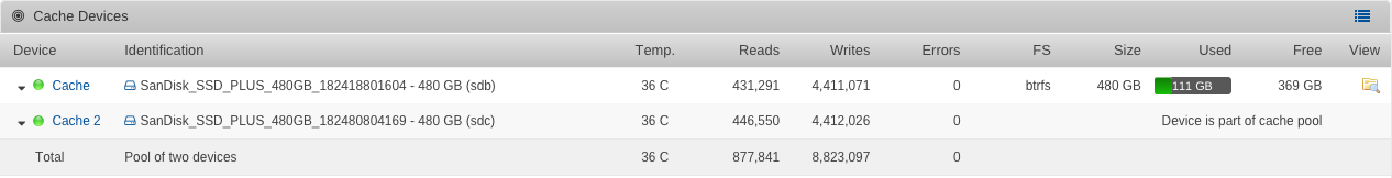

How should the main screen look when redundancy is working?
Very similar to your original screen grab but with more meaningful read/write counts.

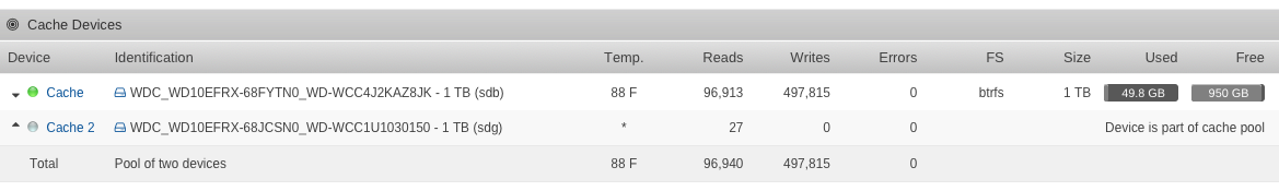

1829072425_ScreenShot2018-09-01at17_57_47.thumb.png.7c14a2ecf7cc833e9bbd8fadf947bba7.png
Shutdown Docker.
Migrated all data off of cache drive.
Ran wipefs commands on sdg1 and sdg successfully.
Moved data back to cache drive.
Restarted Docker.
Reset disc statistics on Main screen.
Still no write operations to the second cache drive.
Did you refresh the page before starting, did the cache2 icon turn blue before starting the array?
If yes and it still didn't work try unassigning cache2, start the array, stop the array, reassign cache2 and start again.
