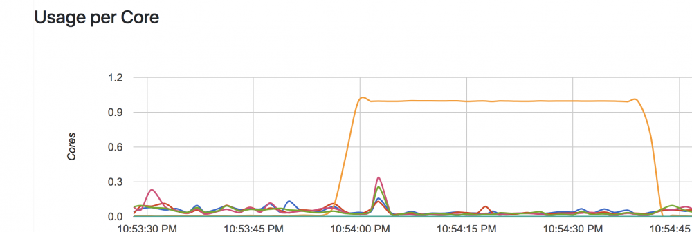

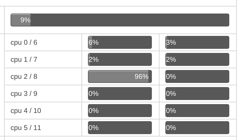

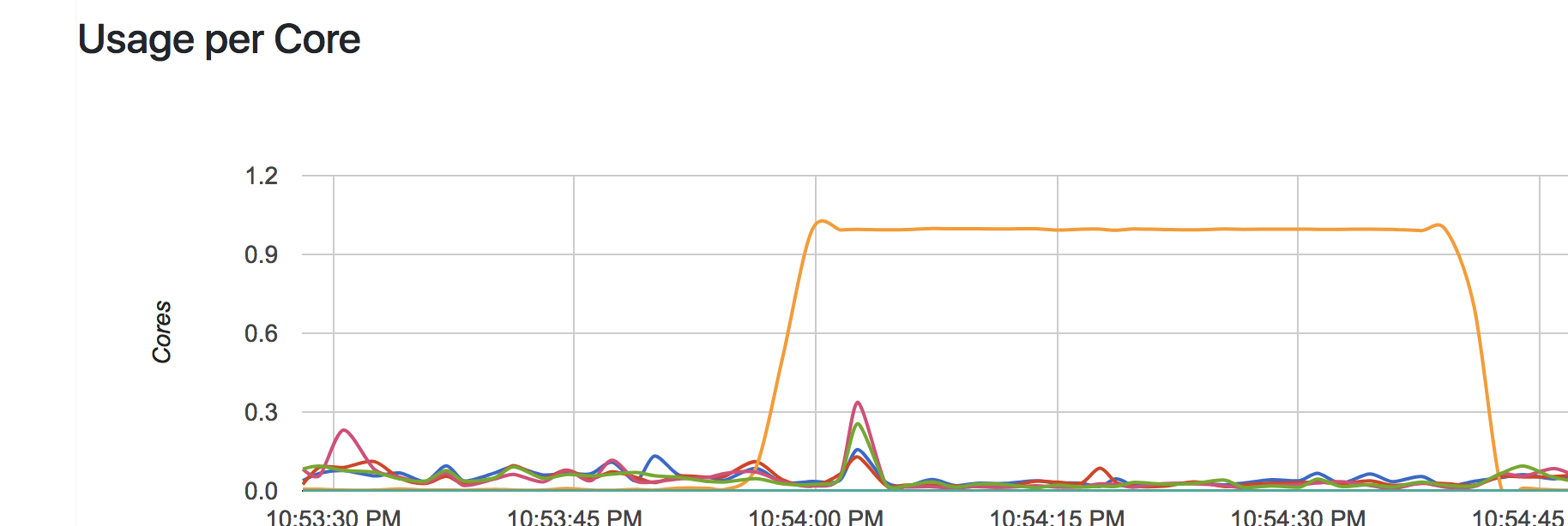

So, watched a few videos put up by SpaceInvader One, and thought to optimize my server. Set up isolcpus to block off CPU 2-5,8-11 so I could reserve that for Plex. Okay, now everything is running in CPU 0-1,6-7. Add cpuset-cpus to Plex, and... Everything is running through CPU2. Regardless of if Hardware transcode is on or not, it's all CPU2. Installed cAdvisor, and sho nuff, everything is CPU2. All those other cores are just napping. I tried reformatting to cpus=2,8,3,9... etc, and same thing. I remove the pinning, and everything routes back through the main cpus (leaving the 8 logical cores alone)...
You can't isolate cpu in the flash config AND pin the same cpu cores to dockers.
  • Your flash config says you isolated 2-5, 8-11.
  • If you set Plex to use any of those 8 cores, it will just max out the first one (in this case core 2) and uses nothing else.
Basically "unRAID" and "docker" are the same thing aka "the host". If you force the host to use something that is isolated from it (e.g. pin an isolated core on a docker), it will go into stupid mode.
