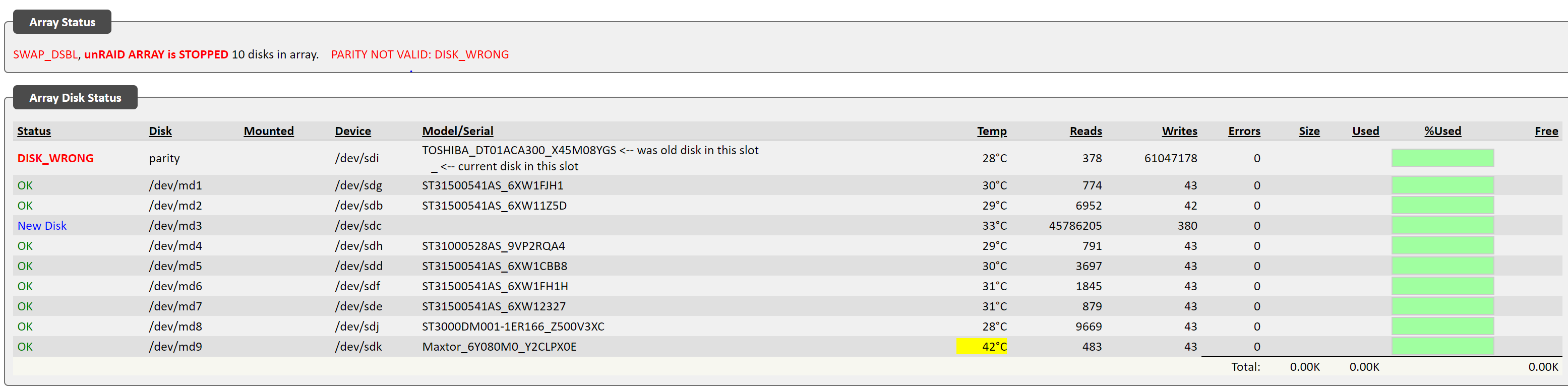

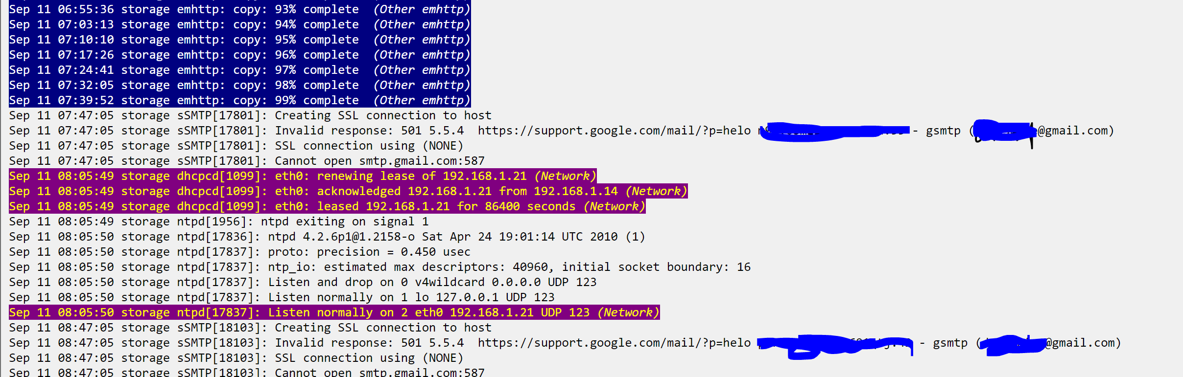

I lost a data disk yesterday and replaced it with a disk larger than the current parity disk and let that to sync over night.  I woke up this morning and it was progressing.  94%...95%....96% so I decided to give it more time.  An hour later, the webGUI won't respond, but the server pings and I can access it via PuTTY.  Hard drive lights show NO activity.  I have access to the unenu plugin webGUI.  I was able to get the following from there:
What would you advise I do next?

Do you mean you were using the swap disable procedure? Looks like that is what the screenshot is saying.

I don't know if the wait is normal for your version or not. I do know that swap disable first copies parity to the new larger disk with the array offline before it will rebuild the failed data disk to the old parity but once the copy is complete it should just be a normal rebuild I would think.

After the parity copy finishes, and I'm not sure yours did or it got stuck at 99%, I'm pretty sure it shows 100% on the log on v6, not absolutely sure on v5, the array should stop and you'd need to start it again to do the disk rebuild.
