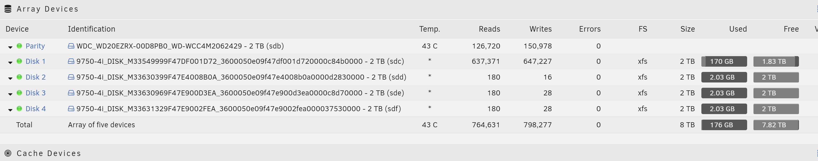

At the moment the ID of the 3ware attached disk have the controller name in it. So when I change the controller the ID of the disk will also change.
Could this cause any problems? Or other things to be aware of?
Thanks Benny
It can cause the device-id to change. Unraid will tell the particular device is missing.
When this happens, easiest to solve is doing a "New Config", reassign all disks and check "parity is already valid".
