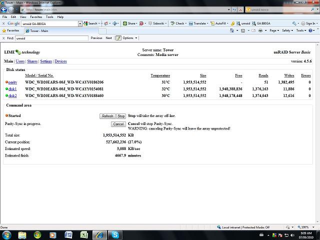

Everyting went smooth until to synch the parity disc.  I have 3 hard drives installed at this time to evaluate the software all connected on the MB (Sata 2.0, not 3.0).
Problem: Parity drive will take over a week to sync.  Is it normal???
See a picture of my GUI attached.
Thanks,
Jean-Martin
No, attach a copy of your syslog to your next post.  It should take under 12 hours on most hardware and with a modern MB and as few disks as you have, it should progress at about 60 - 80 MB/s.  You are running at about 1/10th that speed.

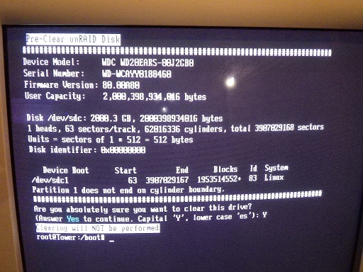

I got the error: Clearing will not be performed
I tried for all drives and got the same errror.
See picture of the screen attaches.
You just need to learn how to read..
It says answer "Yes" (with a capital "Y" and lower case "es") , not answer "Y"
It wants to make sure you really are typing in a response, not just accidentally hitting a key.
Try again, answering with the three letter word "Yes"
Joe L.
