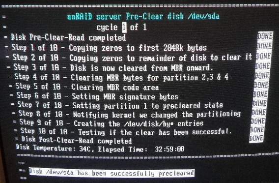

Still under the ''Preclear'' operation after 21 hours!!!  Everything looks good.  I'm in the ''Post-Read'' stage (64%).

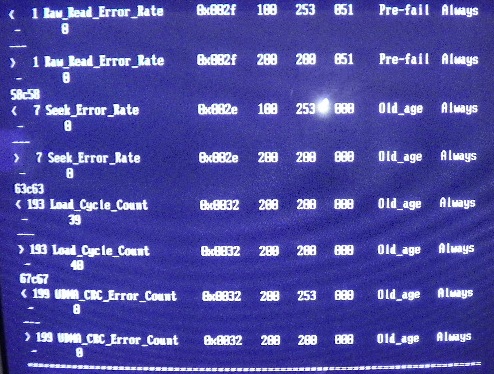

Hello Joe,
Please find attached my Preclear results for my first WD20EARS (finally!).
As you can see, I got some errors.  Do I have to worry about it?
Thx
Not for what is on the picture. Check your syslog for all the details - you may want to copy and save it for reference.

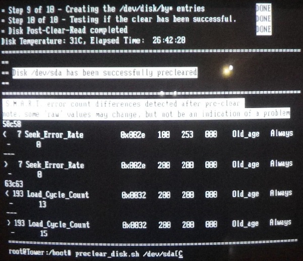

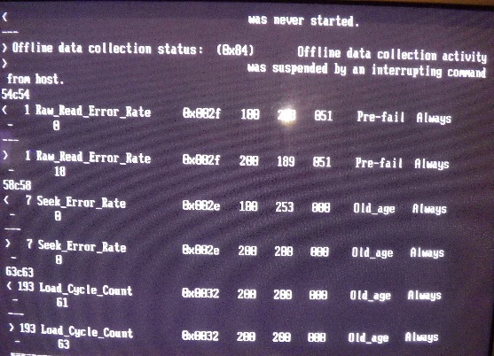

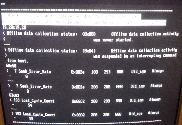

Hello Joe,
Here are the results for my 4 WD20EARS under Preclear operation.
Disk 1 looks perfect but got errors on the 3 others.
Do you see a problem for disk 2 to 3?

Results for disk 2
Results for disk 3
Finally, results for disk 4
Results for disk 2
Disk 2 is fine. It renormalized the values, but in each case the Current Value does not exceed the Threshold Limit.
Results for disk 3
Disk 3 is fine. The values were renormalized, and the Current Value does not exceed the Threshold Limit.
Disk 4 is fine. It renormalized the values, but in each case the Current Value does not exceed the Threshold Limit.
Just about the only SMART sections dealing with errors where there is a human readable RAW VALUE (last column in the report) is Pending Sector Reallocation and Reallocation Events.
