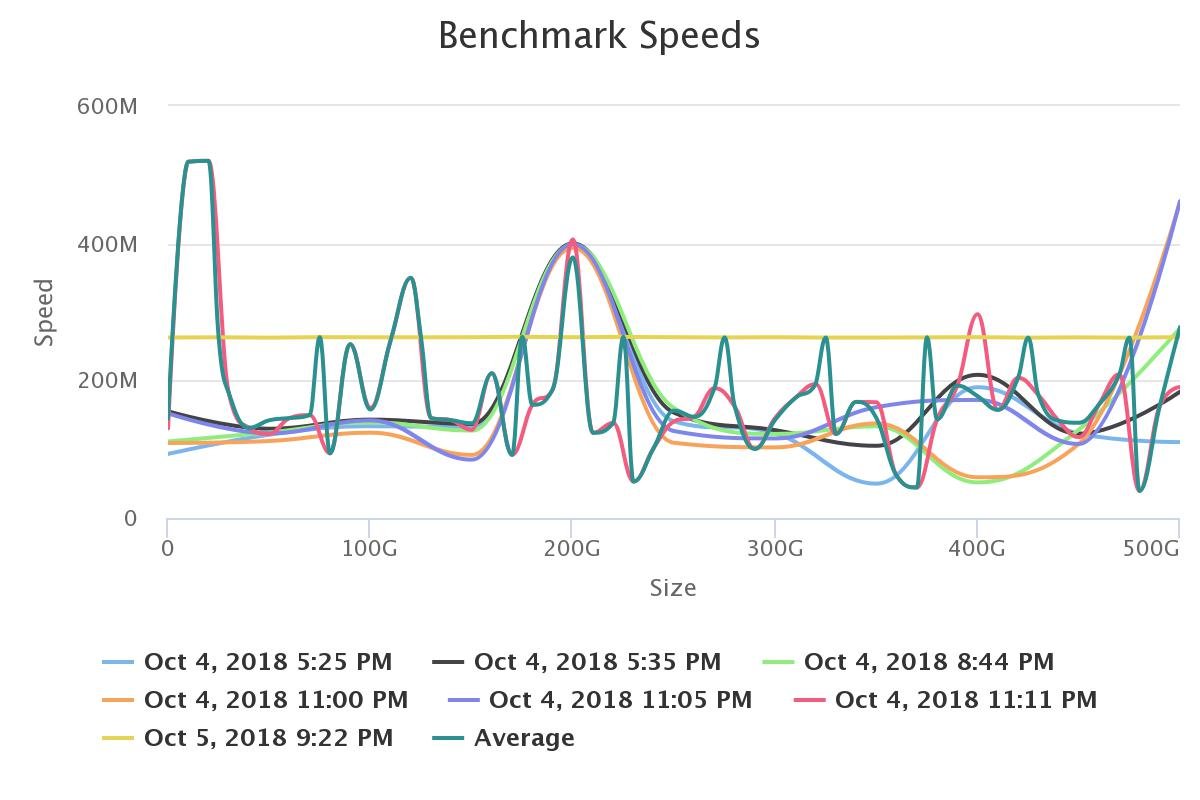

I have a 500 GB Samsung 850 EVO SSD in my array.  The drive was purchased in August of 2015.  During recent parity checks I did catch a few very sharp drop off and recovery periods in the early stages of the parity / rebuild operations.  I'm talking about speeds dropping from 190 MB/Sec down to 60-70 MB/sec.  These drops lasted for a 2-3 minutes and then recovered.

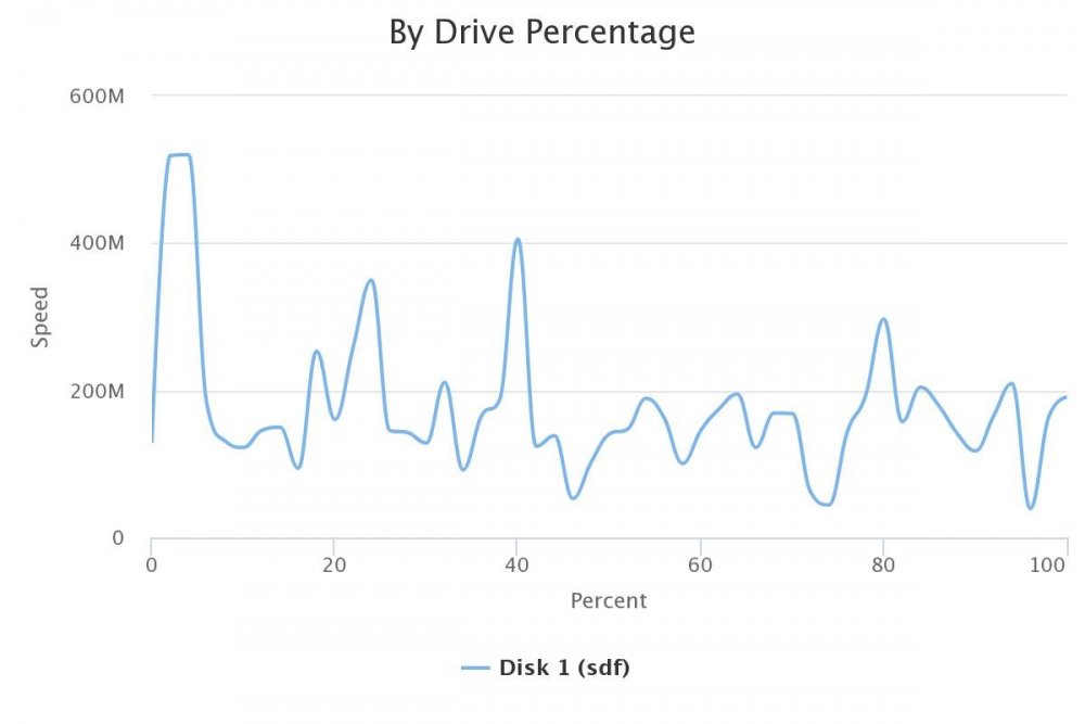

I ran a speed test today and please see the attached graph for this SSD.  Very slow overall and wavering.  I also included a Smart Test report ran today.

Continuing to think about this issue....
If the issue were the age of the data on the drives, why would this show up on a speed test.  I'm assuming the Speed Test (Disk Speed Docker), would be reading / writing it's own data, not just reading what is already on the drive.   Is this true?

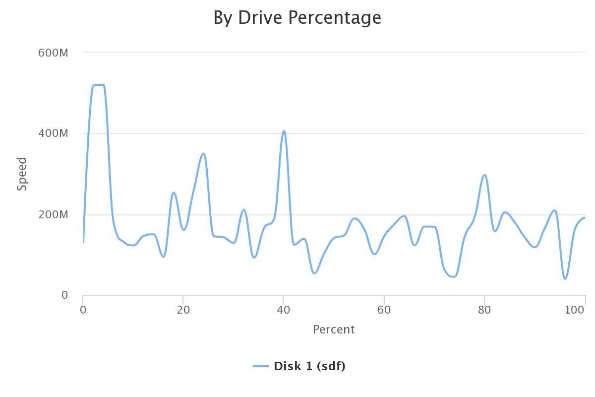

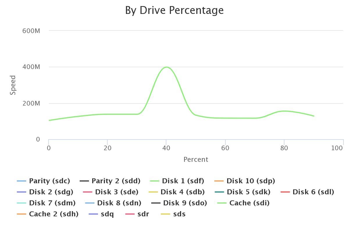

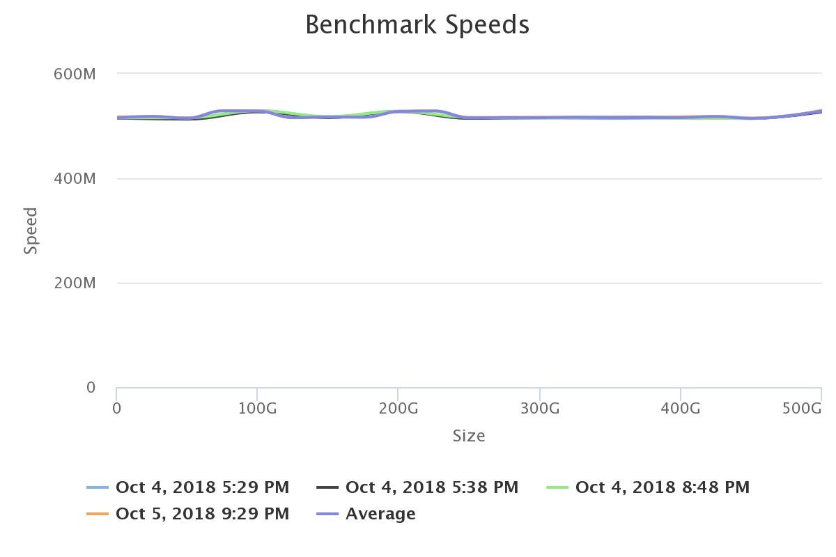

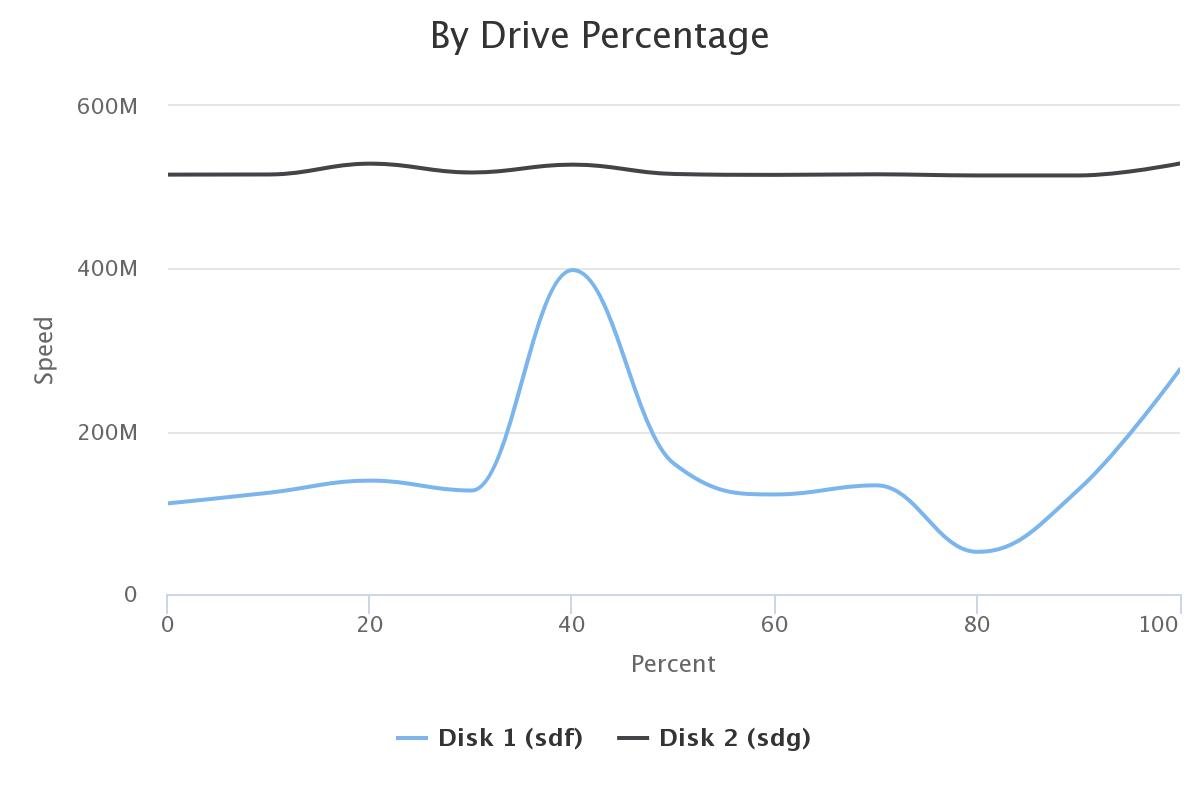

Attached is now the comparison between the new and old drives.  Again, my biggest concern is if this is a pre-fail indicator.   What else can I look for on an SSD?
I ran a speed check every 2%  the previous runs were every 10%.
I think you can actually see where the tips drop below 180 ish and those are probably the places it was dragging the parity check down.

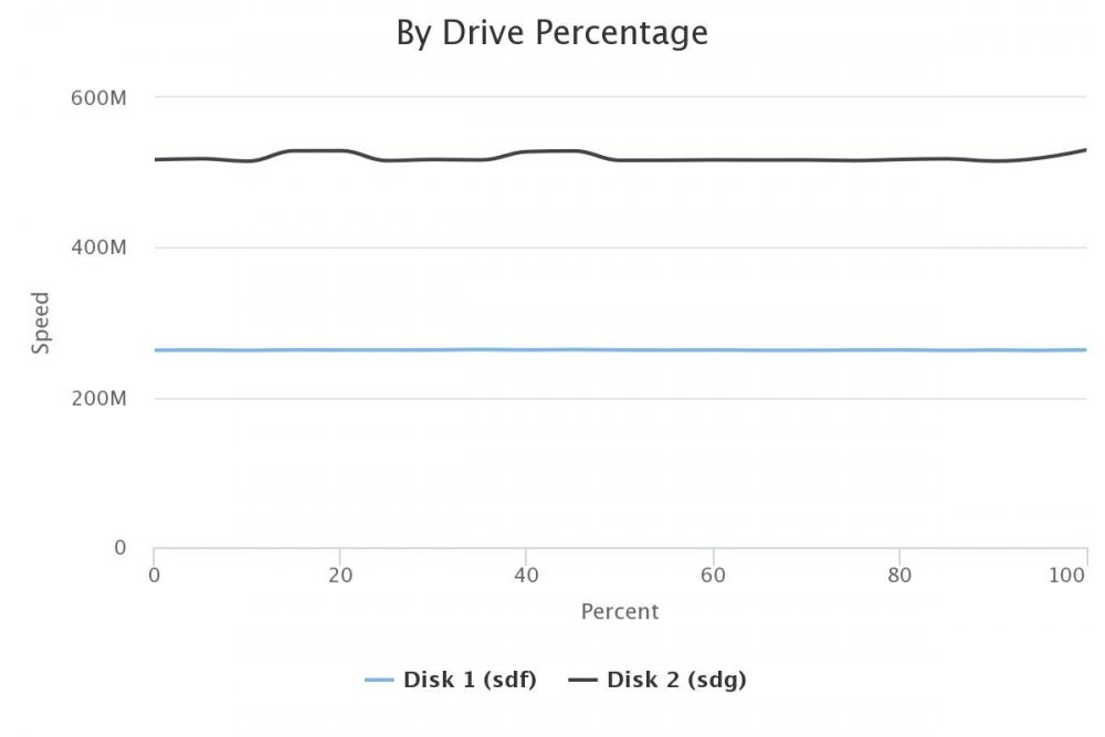

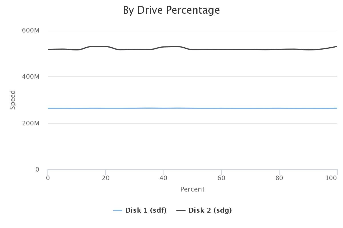

I ran the disk speed test on both 850 EVO drives and here are the results.
Below is drive 1 (older).  The wavy lines are all the test results from yesterday.  The solid line at about 225 MB/Sec is the results after rebuild.  This was done with a test every 5% comparable to the blue green most squiggly line from yesterday which was every 2%.  The others were 20%
The below graph is drive 2, as you can see, unchanged, and also more than twice the speed.
The last one below just shows the two drives right after the rebuild.
