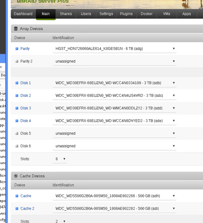

So I just want to double check, this is what the screen looks like now:
I have issues this command at the CLI
I have not refreshed or left the page. Now I am going to start the array, without the "Parity is already valid" selected.
Is that all correct?
Thank you for your help!
Yes
Sorry, to be a pest, when I click start its warning me "Parity disk(s) contents will be overwritten" -your sure, right? :)
Yes, it's normal, the GUI doesn't take into account the invalid slot command, as long as you typed the command correctly and didn't refresh the GUI Unraid won't touch parity and start rebuilding disk1 instead.
