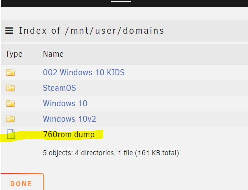

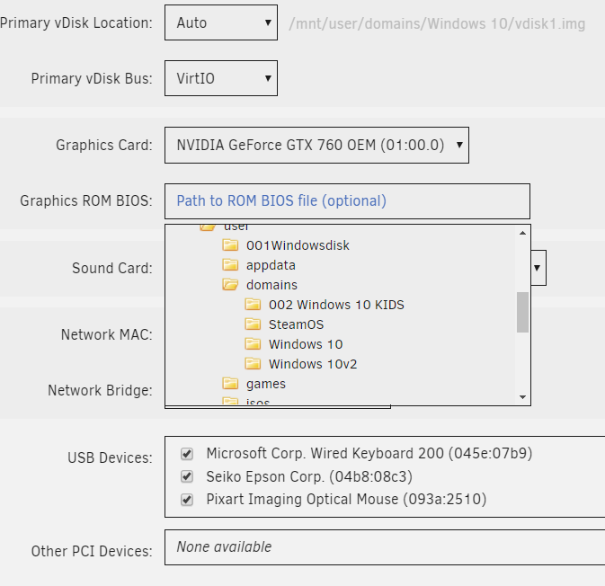

yep sound card is configured But looks like the bios path is not working for me, when I try and add the path the bios file is not showing
ttype85
do you suggest I add the bios path and gpu to the XML?
see my bios are here
but they are not sowing at the VM creation/edit page
i just don't understand I can't see the bios file ?
I guess that why the gpu isn't working?
Rename the file to *.rom instead of *.dump
great thanks!
now showing file in path. woo hoo !
