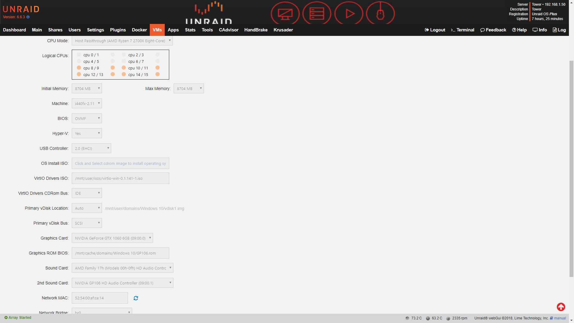

well now this is confusing I have 7-15 pinned for the VM (in the gui) but looking at the xml its pinned all 16 cores/threads (was about to ad <emulatorpin cpuset='0,1'/> to it)
The other weird thing is its pairing 0/8 together but everything else says its 0/1 for core/HT
it also seems to have loaded itself into an 8 cores cpu instead of 4 cores 8 threads

Can you post a screenshot of your VM settings so i can see the core pairings? In your xml you pinned 8 cores to the VM not 16.

The cores are what I'm interested in though with what appears to be a difference between the GUI and XML. Screenshot ad requested

Your CPU pinning looks fine for me. You have choosen 8-15 in the GUI and thats what is in the XML "cpuset=8-15".

Oh I'm a dumb dumb vcpu == cpuset derp.
