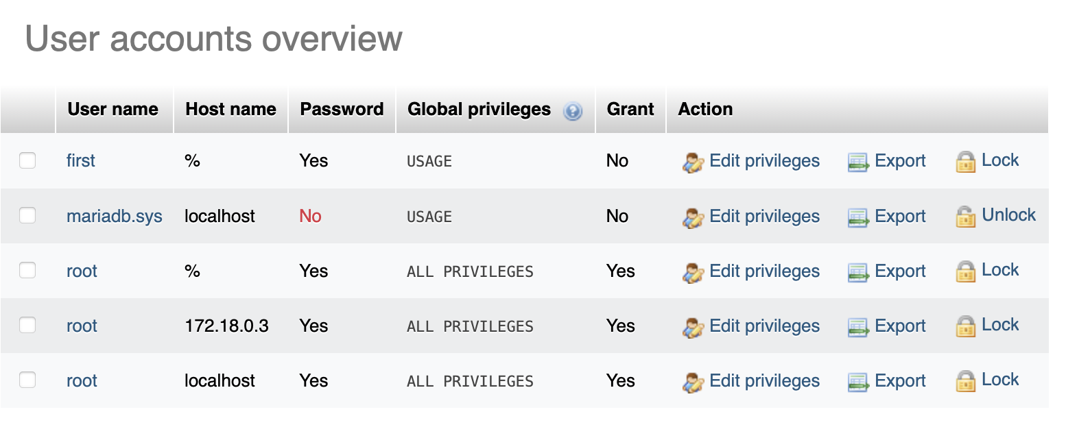

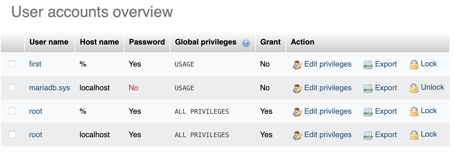

February 1, 20233 yr I am also having this same issue, and have not found a published solution or thread that discusses this. Initially, I deployed the 2 containers on the default "bridge" network. Connectivity from the PHPMyAdmin container can only use IP addresses here, which causes me a problem with hard-coding. My intention is to have a SINGLE mariadb container, servicing the back-end needs for many other app-based containers. However, in the PHPMyAdmin's config, under "MYSQL_HOST", if I put in `mariadb` it cannot connect. If I put in the assigned MariaDB container's IP, it works. Docker documentation, at this time of writing, states "--link" is deprecated and to use networking configuration to allow this. Using user-defined networks allows name-based resolution as well as IP addresses. This sounds ideal for me! At the main "tower.local" console (from the GUI's top-right options), I issued: docker network create main-net I re-created the MariaDB-Official and PHPMyAdmin containers, both connected to this new `main-net` network. In the PHPMySQLAdmin, I was still specifying "mariadb" (the name of the mariadb container) under the `MYSQL_HOST` field. When I try to connect, it still errors. But if look in the MySQL's log file, I see: Quote Access denied for user 'root'@'172.18.0.3' (using password: YES) Which suggests the correct container (mariadb) IS being hit with the PHPMyAdmin login request. The PHPMyAdmin is specifying the "@'172.18.0.3'" as part of the connection string. To test this, I redeployed the PHPMyAdmin container, hard-coding the `mariadb` container's IP address (172.18.0.2). Now it logs in fine! But I have hard-coded. If I go to the `mariadb` User Accounts section, these are the default users in my setup: I created a NEW user, with a specific "Host name" entry of the PHPMyAdmin container, 172.18.0.3 (to mimic the log file entry I saw). Then I redeploy the PHPMyAdmin container to use the `mariadb` as the MYSQL_HOST entry. Retrying the PHPMyAdmin login, which is now successful. Why is the 'root'@'%' not being applied to my authentication, to cover the scenario of `'root'@'172.18.0.3'`? I thought this was the point of the "%" (basically saying ANY host) configuration?
