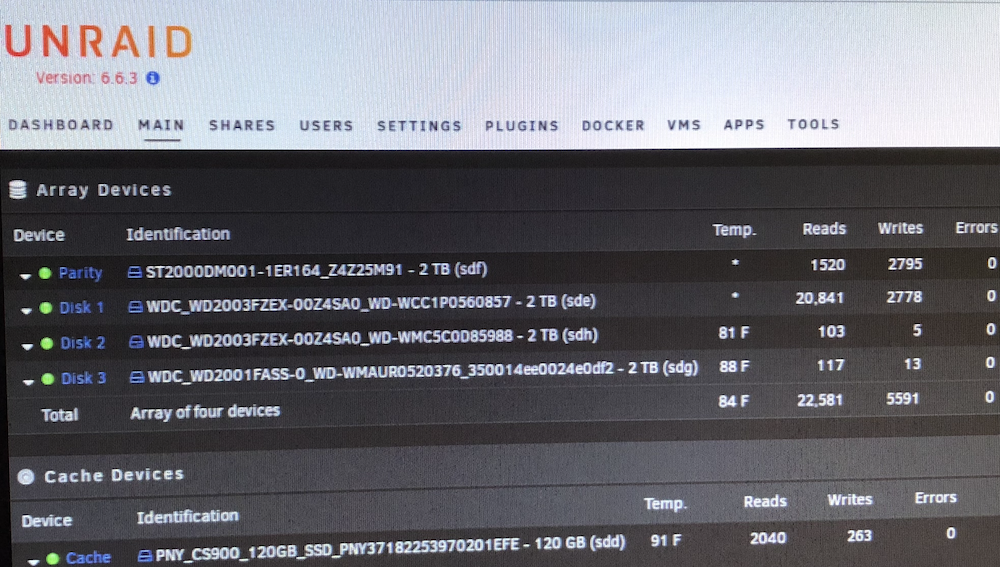

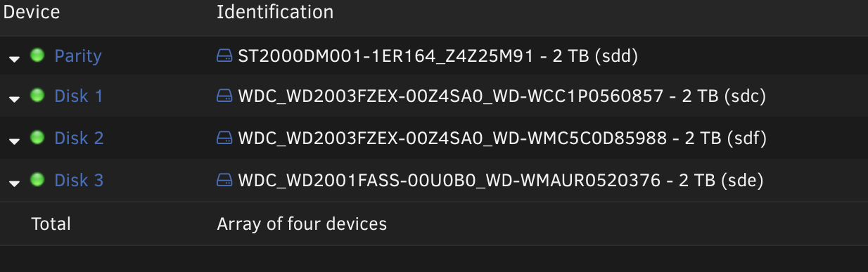

Double checked settings and it looks like it is working in HBA as I see disk name and serials... However, the ending numbers will randomly change sometimes. Not every time, just sometimes. I am wondering if it has to do with some boot order thing because when I first set the array up parity was (sdf), disk 1 was (sdc), disk 2 (sdd), and disk 3 was (sde)

Device names will change. The mappings of sdX are NOT persistent, they should not be relied upon. This will NOT cause any issues.
I figured as much but, the device name should be persistent right? if the mappings of sdX are not persistent but do not affect device names then what else should I be looking at?
UnRAID works off the model number/serial information.   If that is not staying constant then you have a HBA related issue.    As was mentioned the sdX type part can change between boots and is not important to UnRAID.
Please post an example of how they change, compared to the earlier screenshot

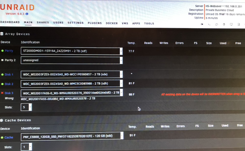

Here is what happens to me every once in awhile...finally got photos of it.
It adds this crazy extra tag at the end randomly...

That's a controller problem, look for a firmware update, failing that replace it with one of the recommended controllers.
The H200 is on the list so I guess maybe firmware issue then. I seems it was rebranded to there might be newer firmware I wasn't aware of before.
