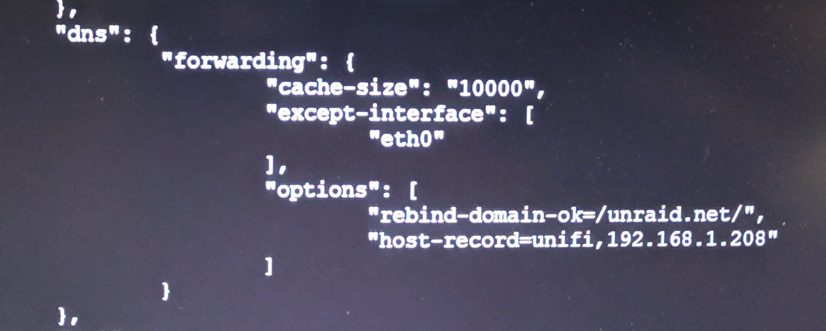

I have to the best of my knowledge configured my router (Ubiquiti USG) correctly using a .json file (see below) for the command unraid gives you in the help section for the provisioning. I have confirmed this by checking the configuration through SSH into the router (see attached picture).
   "service":{
      "dns":{
         "forwarding":{
            "options":[
               "rebind-domain-ok=/unraid.net/"

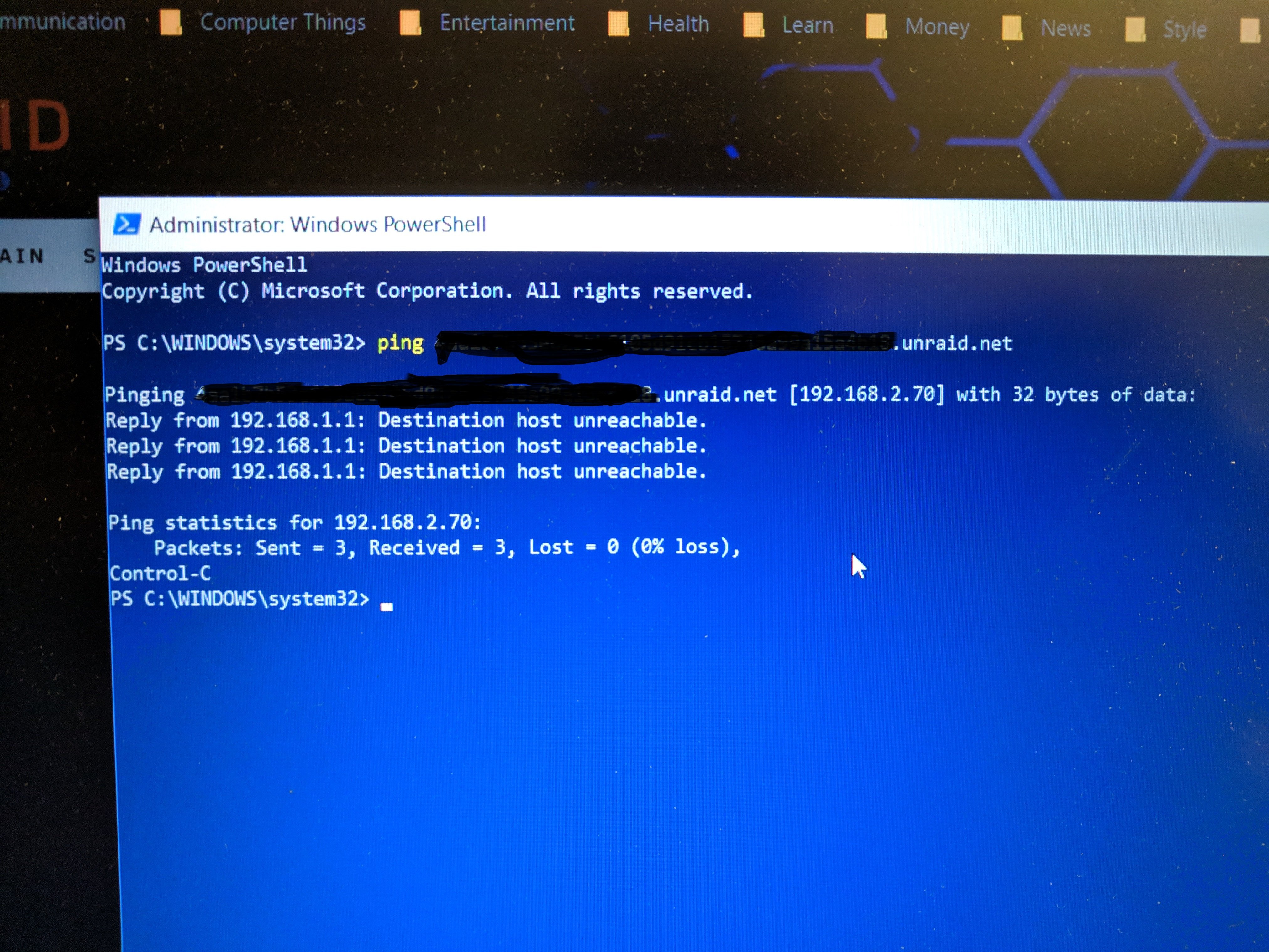

From running tests I believe there is an issue with the IP address of the provisioning SSL cert. I had recently switched my networking set up and the cert seems to be trying to go to the IP address of my server from before switching the network setup. The local IP on my UnRaid server was 192.168.2.70 but with the new set up is 192.168.1.207 however as you can see in the attached picture the SSL cert is trying to go to 192.168.2.70.
