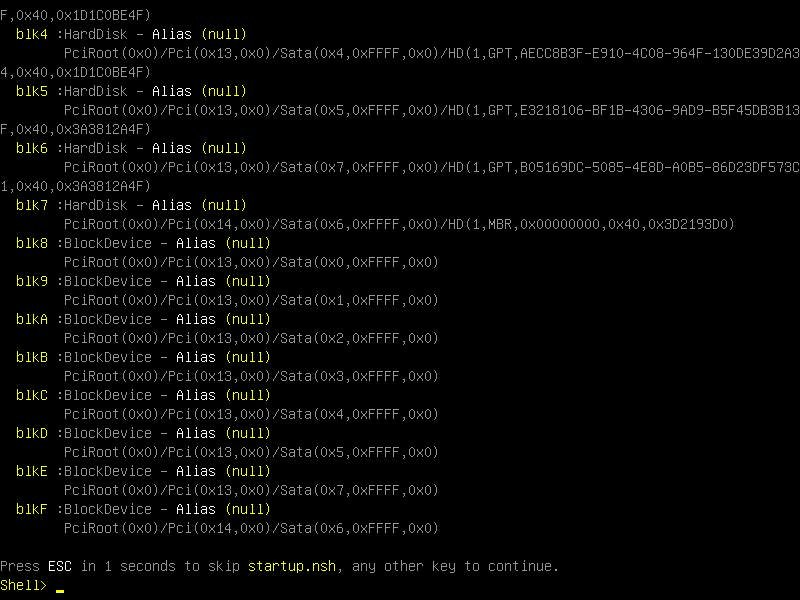

I logged in to the ipmi and sent a reset. Now, the server is not booting up.  See screenshot for what I am getting.
It looks as though you've booted into an EFI shell. Your boot flash device might be corrupt. Shut down and unplug it. You can check it by plugging it into a PC and running the disk checking utility on it.

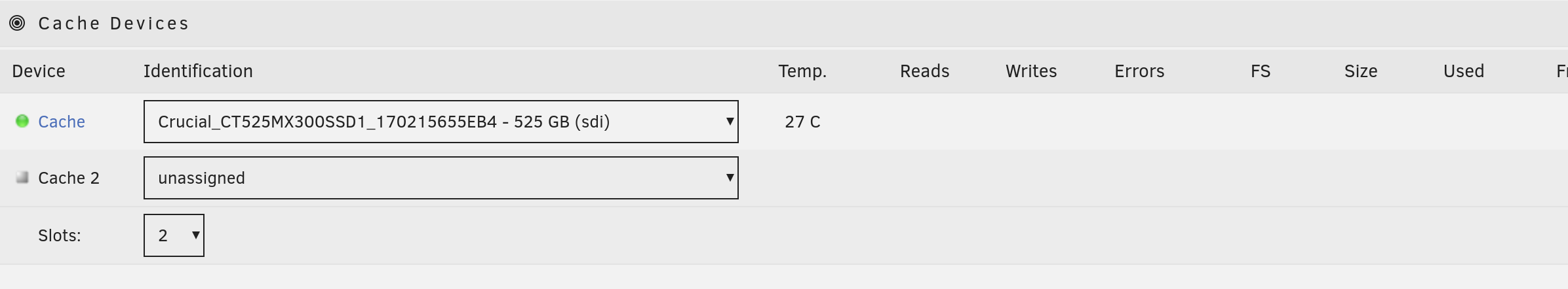

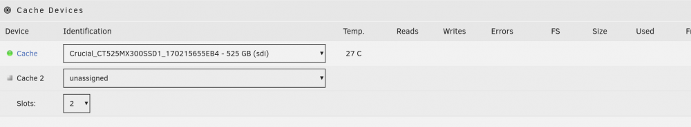

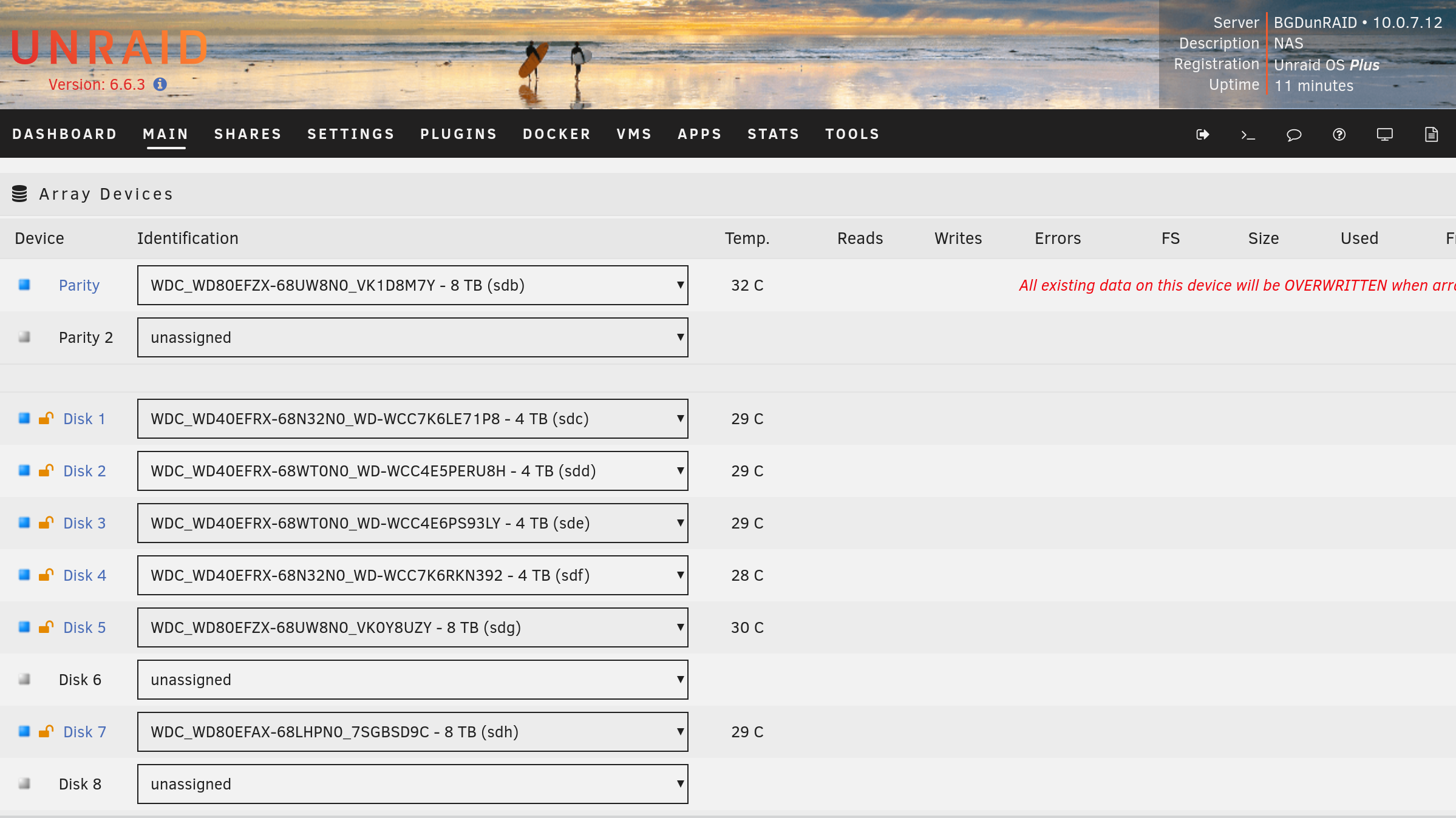

I have 6.6.3 on the new flash drive. After applying the new key, I am getting the encryption PSK now which is good; however, before my old flash drive hit the can, I had my cache drive encrypted. Now, my cache drive is not showing that it is encrypted and my hard drives have an orange open lock icons. Also, I am getting this error message:
All existing data on this device will be OVERWRITTEN when array is Started
Edited by pingmanping
added another screenshot
This is referring to the Parity disk. Unless you check the box saying parity is already valid then parity will be rebuilt after a New Config.
What about my cache drive showing it is not encrypted?
Do I need to re-encrypt the cache drive?
I copied the config and syslinux folders from my backup back in July (can't remember if my cache drive was encrypted when I created this backup) to the new flash drive. All my latest flash backups are located in one of my Share folders.
Before starting the array click on cache and change the filesystem to correct encrypted one.

I clicked the option "Parity is already valid" and started the array; however, it has been 5 minutes and the array is still starting. Usually, it doesn't take more than a minute for me to start the array, but this time it has been 5 minutes and at the bottom shows "Starting services"
It seems like it is stuck in "Starting services"

Have to reboot via the IPMI and now it seems like I am able to build the array. However, the cache drive is in this state:
Unmountable: No file system (no btrfs devices)
I tried to recover the data from my cache but getting this error when I try to mount it.
mount: /x: unknown filesystem type 'crypto_LUKS'.
All my shares are gone. But it seems like I still have my data when I clicked on the folder icon in the Main page.
Is there a way for me to get back to the state where I have my unRaid before the old flash died?
Also, I am reformating the cache drive, but it seems like it is stuck in "formatting" state.
Added info
