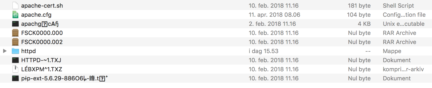

I'm talking about the files under UNRAID > plugins > apache
Here is what it looks like atm for me. the FSCK* files I was told is something unraid does when trying to uncorrupt data on the flash drive. but as you can see. Some of them are now null bytes, and has some weird naming to it.

Hello everyone. I have finally fixed it. The reason why the webgui was not showing up, is that it overwite the network.cfg file with a GUID value from something (no idea what) I installed a new usb, and compared almost all of the files from the two. And now.... NOW IT WORKS AGAIN - and i'm even on 6.6.5, YES SIR!
Thanks for all the help! I will from this point on, never update to a new OS without a backup of my USB drive 😮
