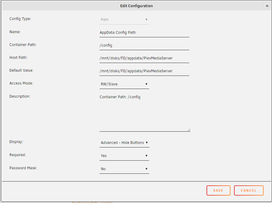

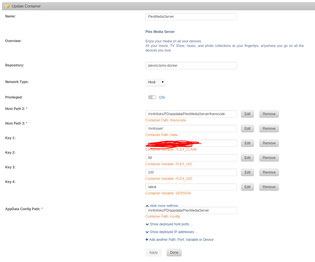

I'm using Unassigned Devices to run the Docker and here are my settings.

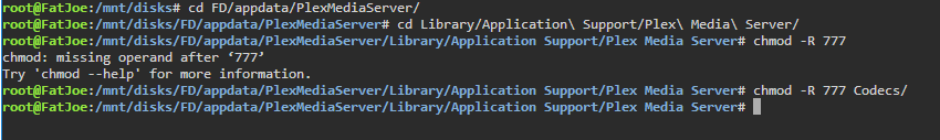

Try doing a chmod -R 777 /mnt/disks/FD/appdata/PlexMediaServer/Library/Application Support/Plex Media Server/Codecs
should i do this for the transcoding folder also?
i get this error when trying to run the command
Edited by ToXIc
ok got it done..

For file/folder names that include spaces you need to enclose it in quotes.   By default spaces are treated as parameter seperators
thanks.. for the info.

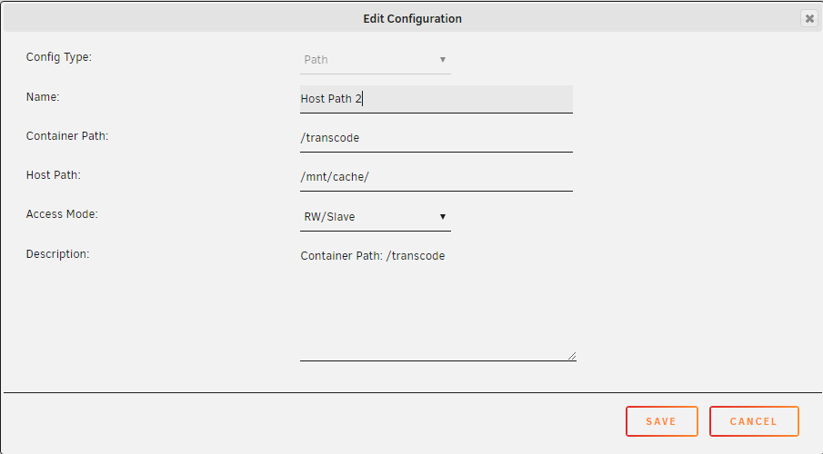

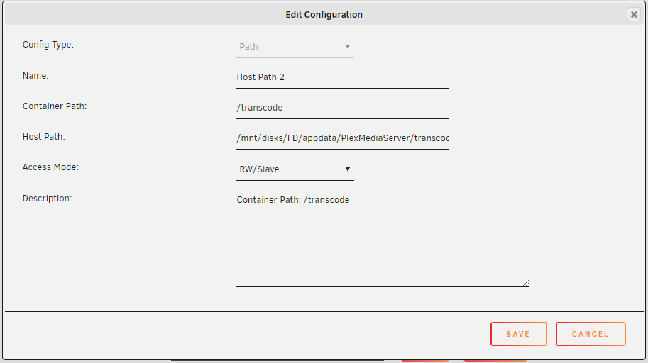

Have you tried the slave option for the transcode mount? Try that or use the cache disk or an array disk for the transcode just for fun.
it is set to slave, or do you mean another option?

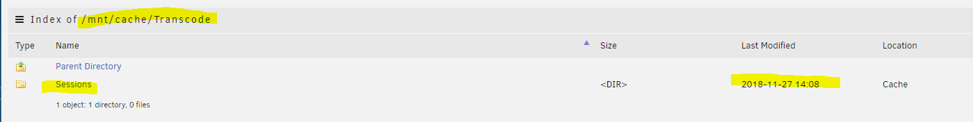

if i set it to the cache drive will it then write to the array?
edit: I changed it to the cache but it still not transcoding..
also it did create the folders on the cache drive.. it just didnt transcode.

That was the slave I meant.

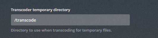

You do have the transcode path in plex settings set to /transcode?
i do

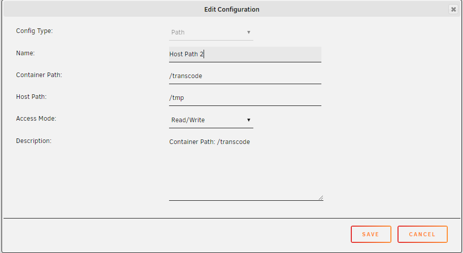

yes a few months back after i couldn't figure it out.. deleted the docker from linuxserver and setup a new one from the official repo and had the same problem.
i was given the suggestion to use RAM but that failed also

are these options correct? whats the section on the bottom?

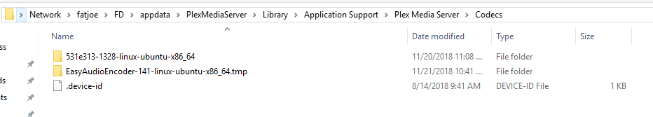

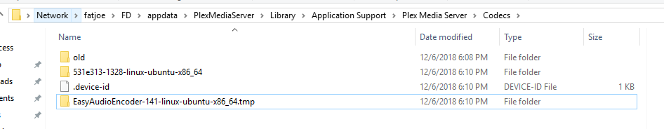

also move the contents of the codec folder into a folder called "old" restarted the docker and it put back the following
but i still get the following error

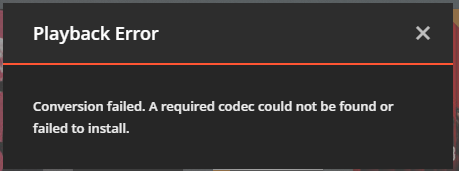

I started getting this error below when trying to play any mkv's. I then chmod the /tmp/transcode path to 0777 and now they are playing again. I am not sure what caused the issue as the day before all was fine.
Conversion failed. A required codec could not be found or failed to install.
