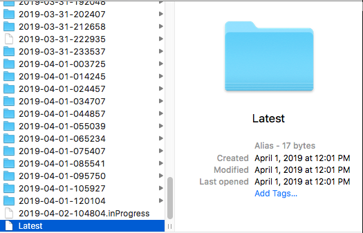

My Time Machine External HD just crashed at 12:01 on April 1. I guess it was trying to tell me it wasn't an April Fools joke:
Anyways, I set it up the way you wrote it up with a few changes and have my backup running right now. Fingers crossed.
