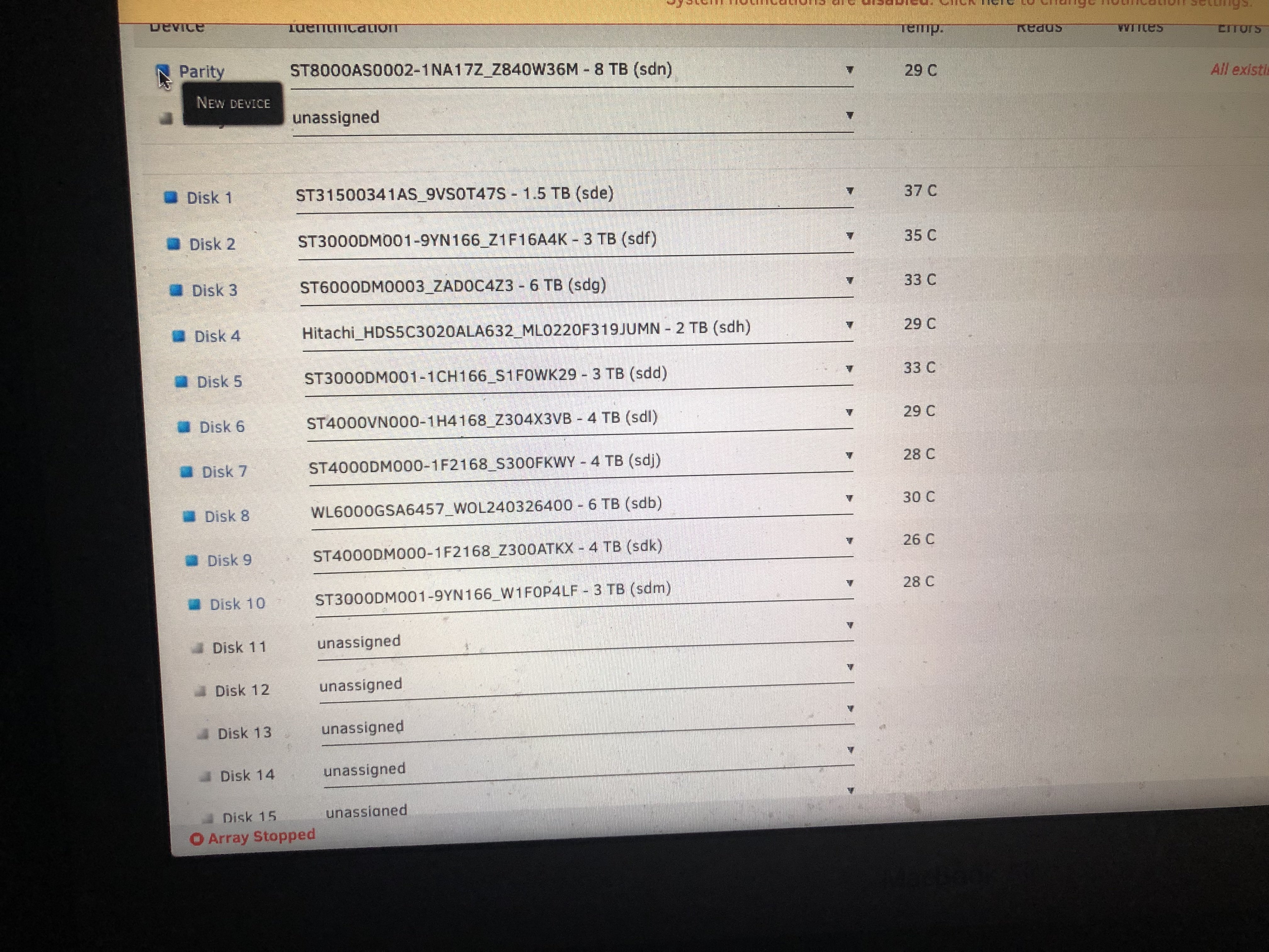

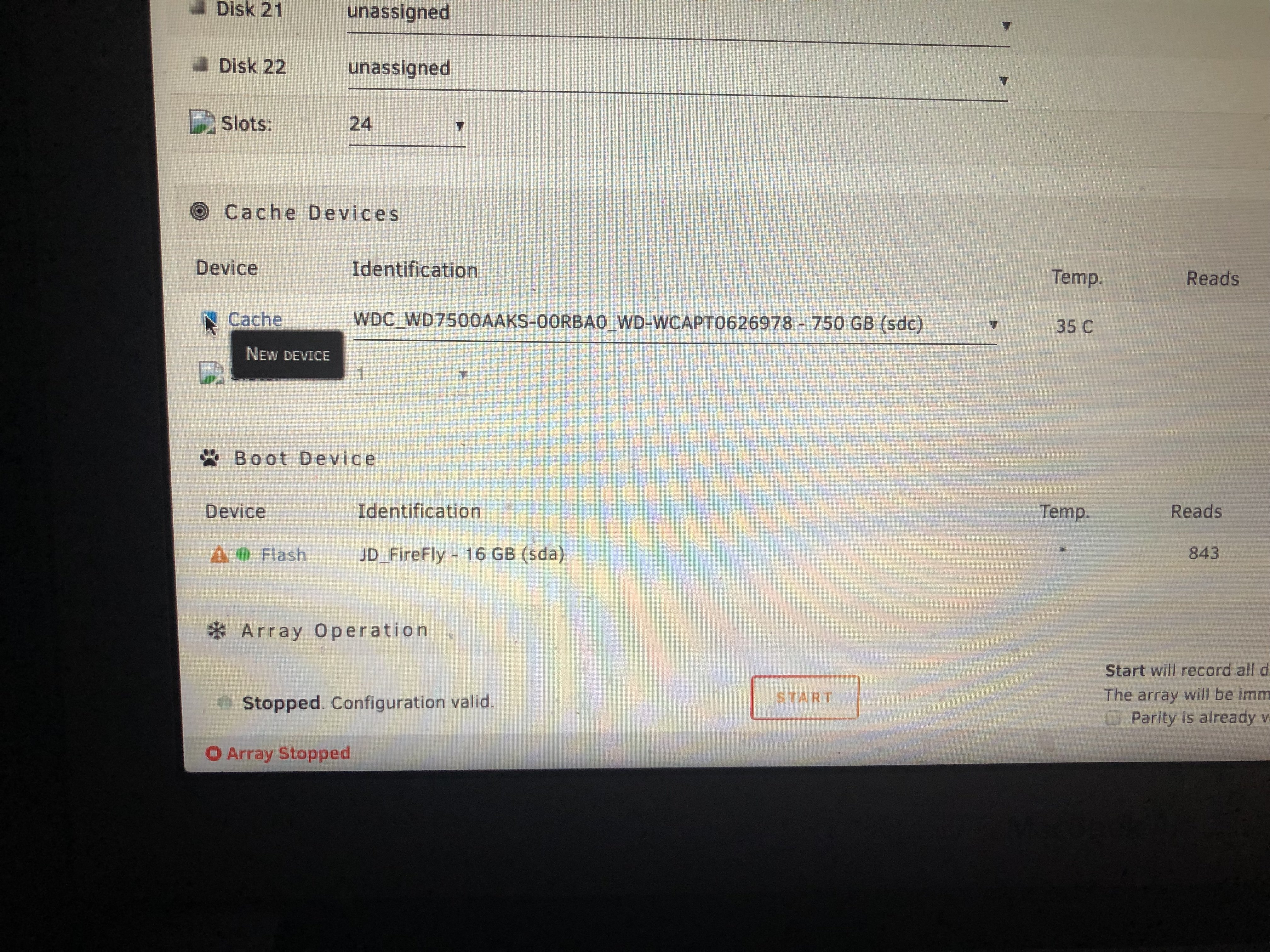

Okay guys hold on. I just assigned the parity and cache drive like before and I got a blue square next to theboarity and cache drives that indicates “new device”
I don’t recall seeing that before. I want to make sure that’s normal and that unraid doesn’t erase all my data if I start the array like this!
im not starting until you guys give me the go ahead
Edited by maxse

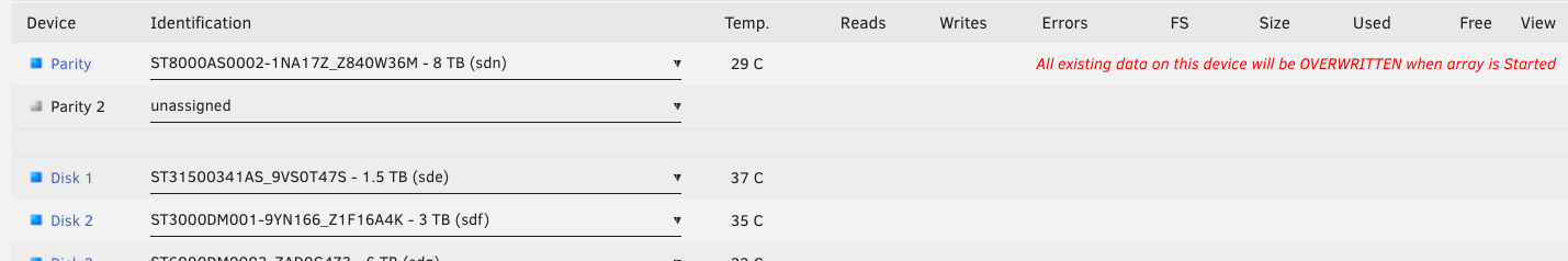

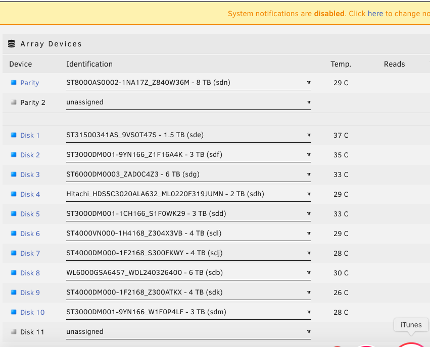

Okay, so I’m getting that blue square indicating new device for all of the drives that I’m assigning.
Also, I’m matching the serial number of the drives the Disk numbers in unraid. It seems that some of the abbreviations have changed though (sdn) labeled drive that is now the parity1 drive used to be labeled as sdm. Parity 2 drive (that I cancelled the parity on) was actually the one that was sdn. I didn’t assign the second parity this time around.
Just waiting for for you guys to tell me what to do. Didn’t actually start the array yet. Parity 2 is unassigned right now.
I don’t even see the message that I saw last time that asked me if the parity already existed. It just says “start will record all disk info, bring array online and start Parity sync”
Edited by maxse

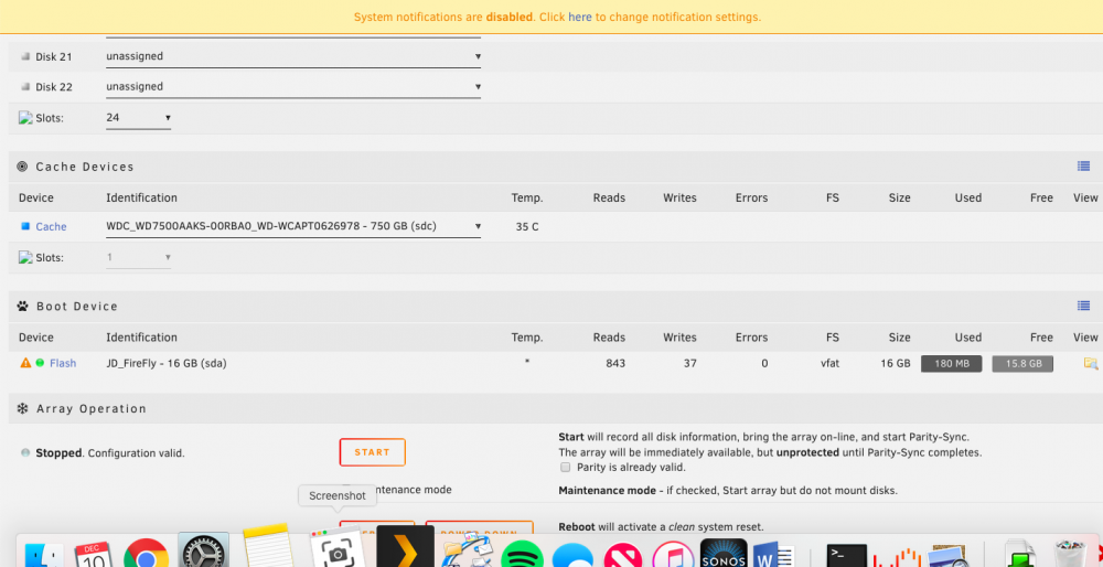

Post a screenshot
Are you taking photos because you are using the webUI on your server booted in GUI mode?
The webUI is just a web interface to your server and it can be accessed from any computer on your network. If you do it that way you can actually do a screen capture and post it instead of these photos. A real screen capture would be a lot easier for you to make and post. And more complete and easier for us to read.
lol, no sorry;I'm on the webui. I figured it would be faster and I never played around with the screen shot app on the mac. Just figured it out, good point. Attaching belowScreen Shot 2018-12-10 at 11.24.07 PM.png
Edited by maxse
Yes that looks good.
The drive "letters" can change between boots. Most of the time you don't even need to know them. The serial numbers are what Unraid uses to keep track of the disk assignments.

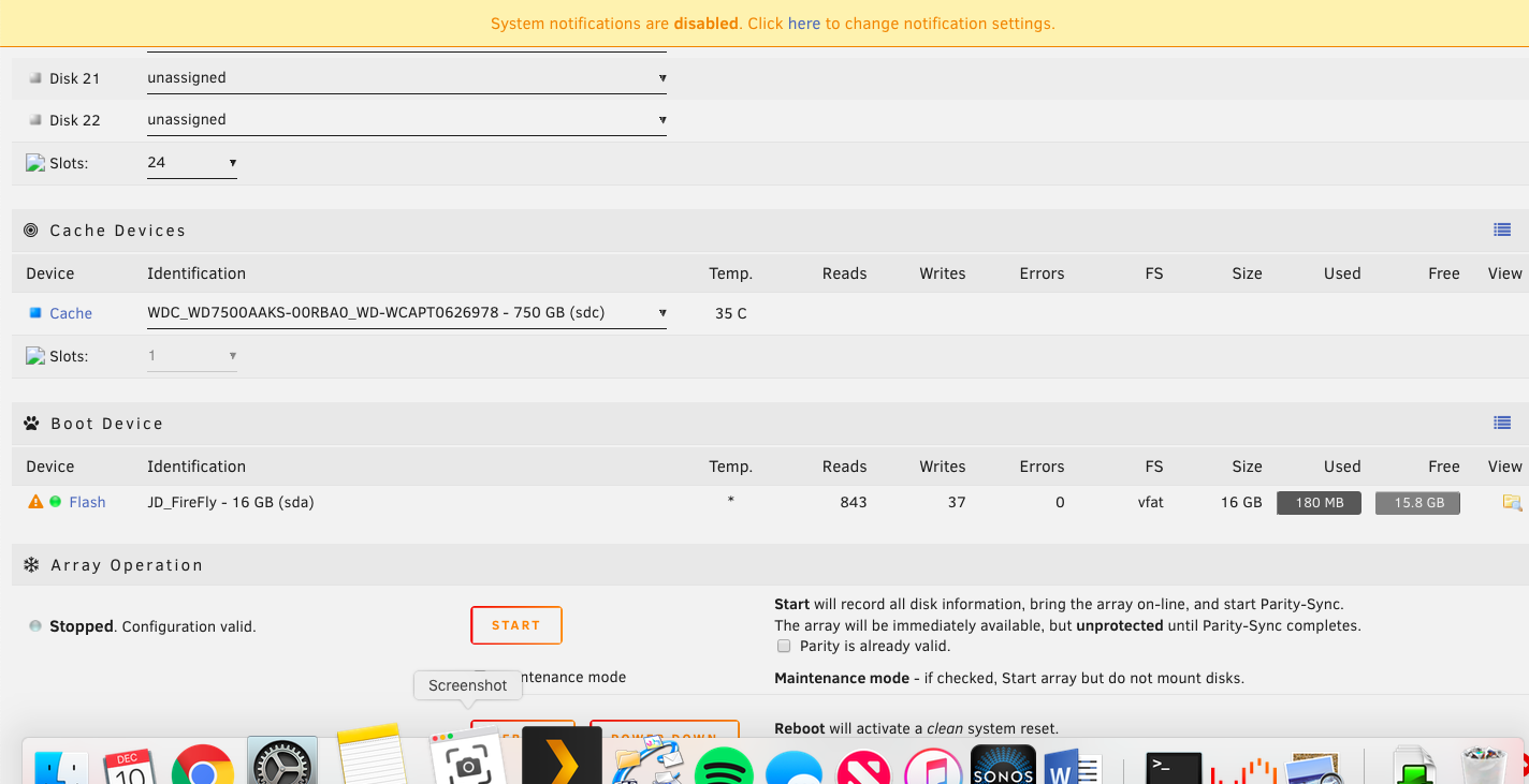

so I'm okay starting it even with that blue square next to he drives saying "new device" and no giving me an option that a parity is already valid like it did somewhere (I don't remember exactly where) the first time I upgraded 2 days ago? Didnt capture on first screen shot. says all existing data on parity drive will be erase, even thought I just finished building that parity 1 day ago140723018_ScreenShot2018-12-10at11_33_04PM.thumb.png.6760ab32fe45218089e67125c82076e6.png
Edited by maxse
Your screenshot has the check box for valid parity. Check it before starting the array.
DONE! Thank you!

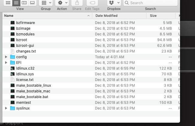

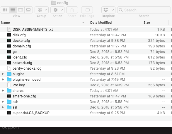

BTW, I just checked the backups share that I created for CA Backup that's on the arrar, I went to flash folder and the config file is there and it seems to be correct. So it seems my path was correct? So I don't know what happened or what created that SS folder? Do you think I got a virus somehow??
Anyway, I'm deleting the flash backup, appdata backup and libvert backup folders that I made from the tutorial for CA Backup. Will address that later I guess. I want to start fresh.

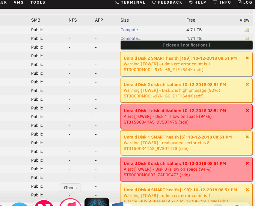

I guess I can address the errors below later? lol

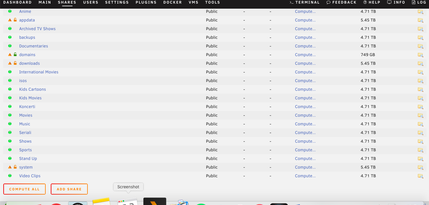

Why are some of the shares showing higher capacity then others? Like 5.45tb vs 4.71 on the others? 1881745249_ScreenShot2018-12-11at12_16_07AM.thumb.png.657ecc2ad232b2faac13256e3f9f49e5.png
The ones with the higher capacity probably have files on the cache drive (notice they have an orange triangle icon) , so the cache drive size is being included in the size calculated.
^^^THIS
You can click on the Compute... link next to each share to see what disks they are using, or click on the Compute All button to get all of them computed. It will take a little bit of time to get the answers.

Thanks so much. I’m getting a bunch of alerts and errors right now. I’ll get to those once I copy important stuff to the backup server and set up CA backup.
