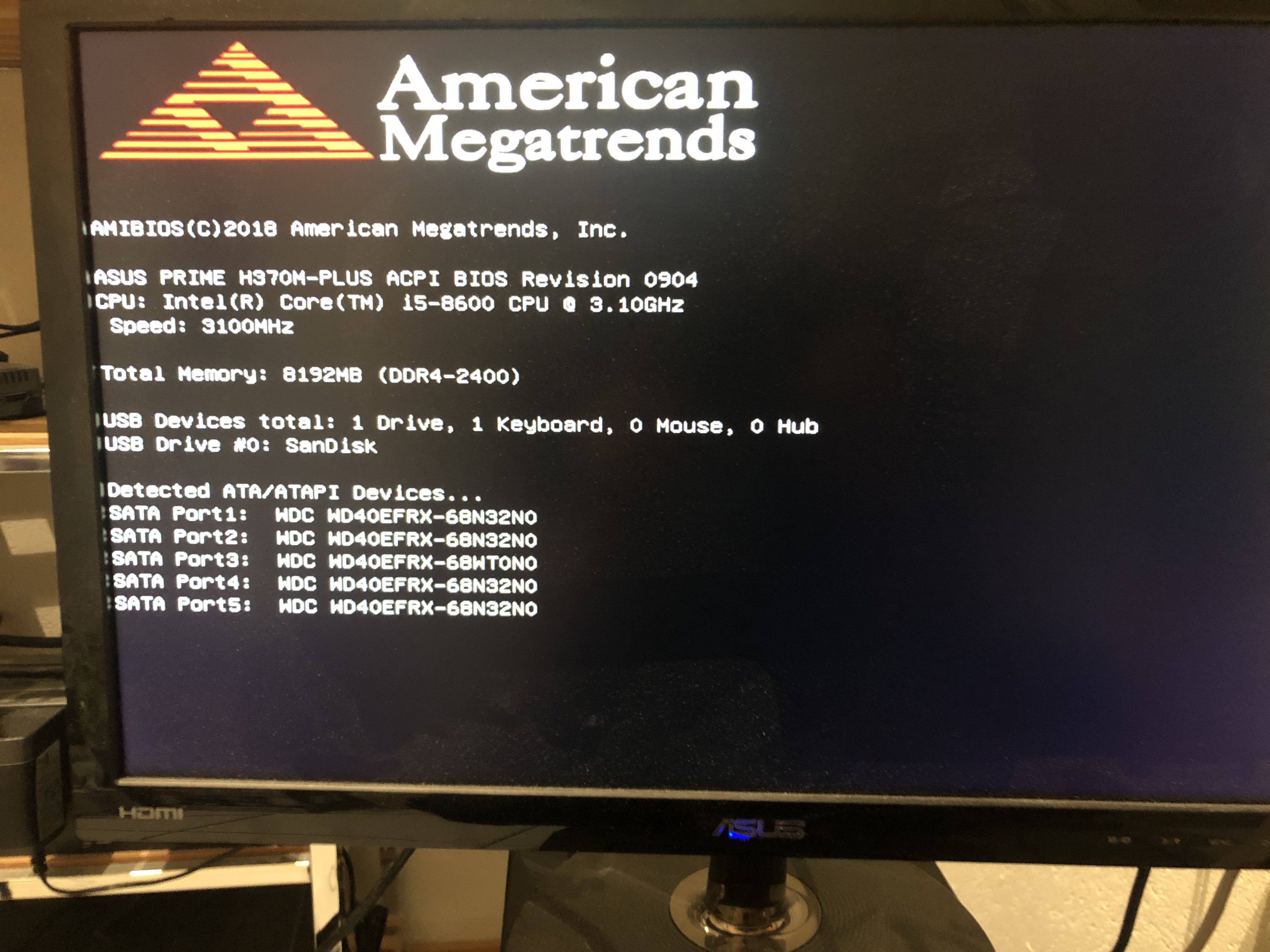

Here is what I get at boot time
I expect you would get that even if it went ahead and booted from flash. BIOS isn't something that 'boots'. It loads before booting can even happen, since the Basic Input Output System is required to be there before it can read the boot device.
The question is whether or not it continues from that point. Does anything else happen after that if you wait a bit? On some systems you will get a message telling you it didn't find a boot device. On some systems you just get a blinking cursor. On some systems if it doesn't find a boot device it goes directly to the BIOS Setup screens. And on some systems it just takes a little bit of time for it to detect or check the hardware before it continues to boot from the assigned boot device.

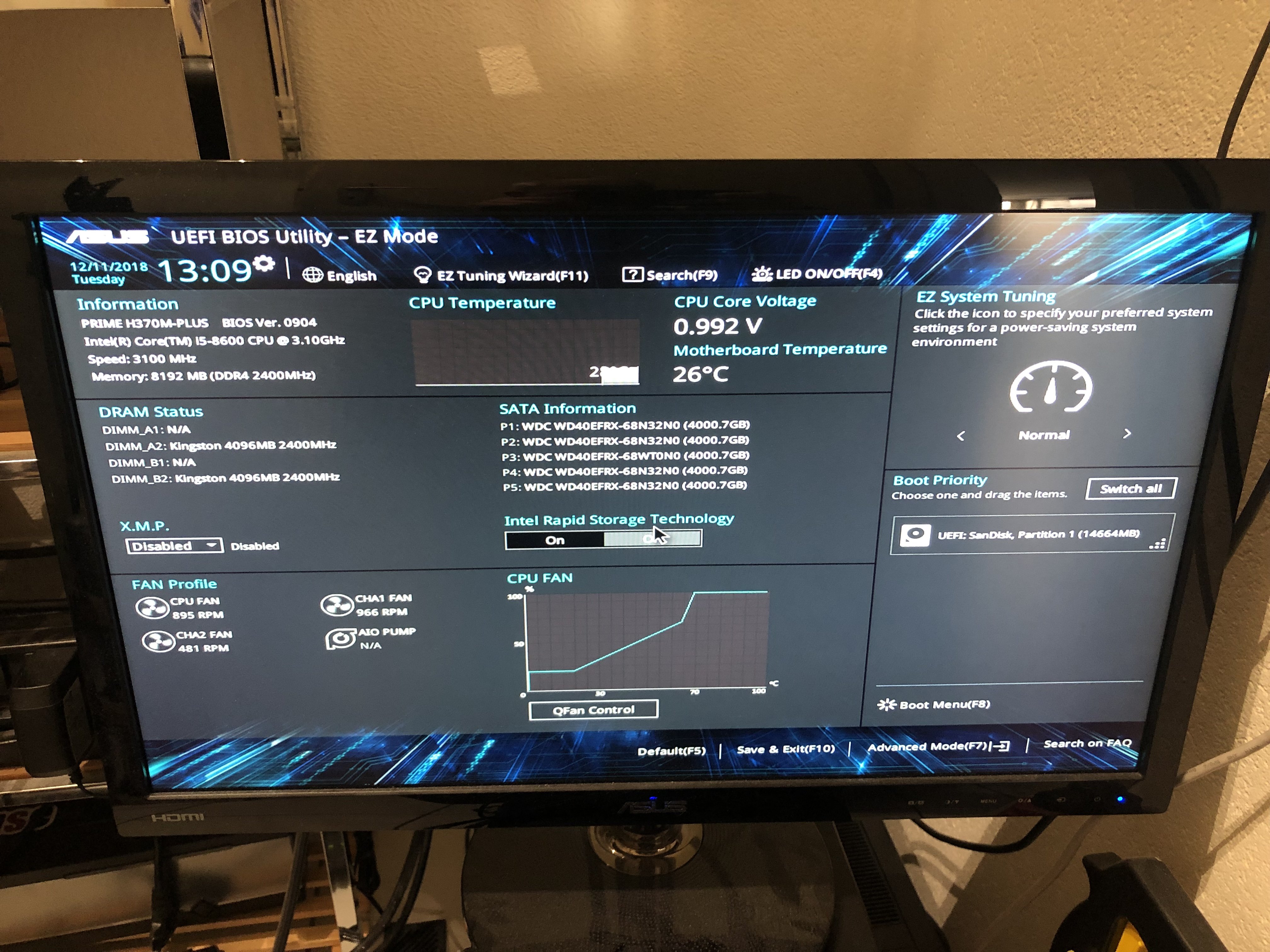

Here is the screenshot of the bios screen that appears now every time I boot.
If you need more screenshot I'll be happy to provide them.
Thanks
Ok nevermind I finally found the issue. In the boot tab I had to activate the csm compatibility option. Now I can boot unraid and everything is well again.
